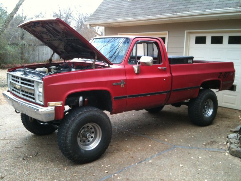

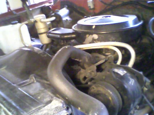

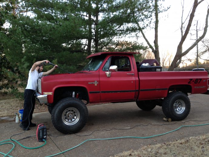

Pictures

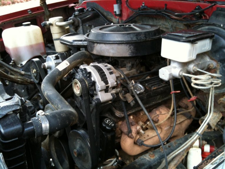

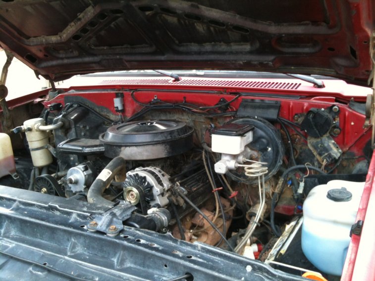

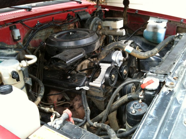

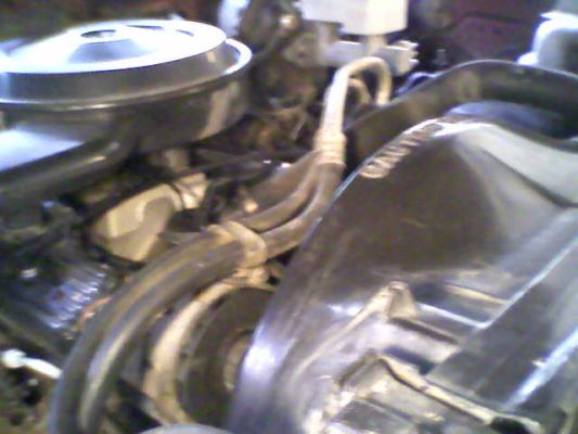

Old tbi one belt

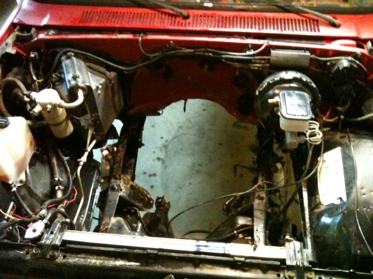

Removal of drivetrain
