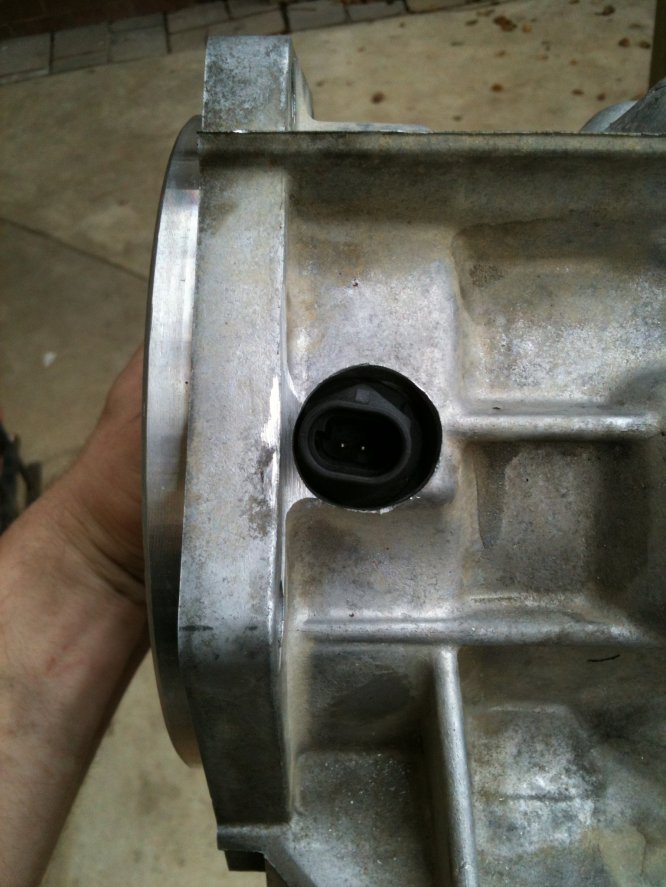

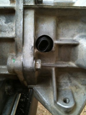

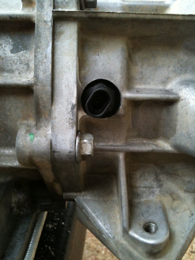

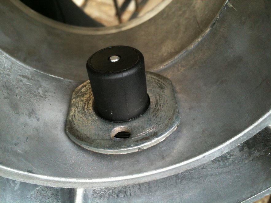

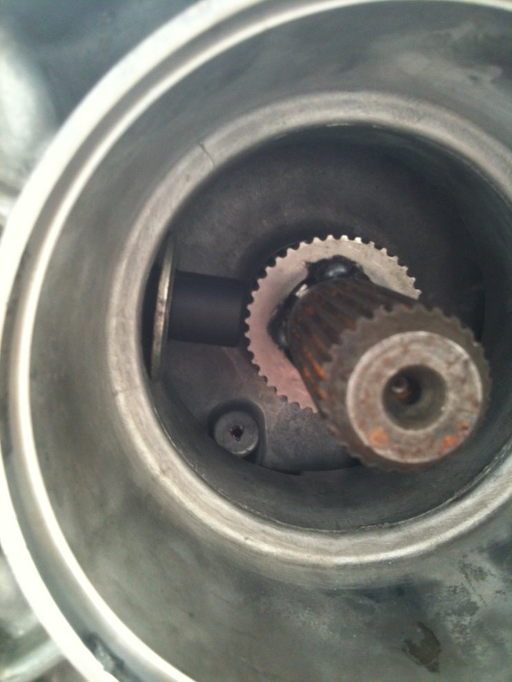

I'm gathering parts as we speak to convert my 87V10 and want to retain my 208 just as you have. Is there any chance I could get a couple pictures of the reluctor wheel mod on your Tcase?
Also, is this still running as it should?

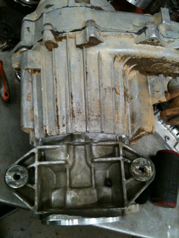

Yes everything is still working great a year and a half later ! Im runnin a 4L60e and the original '87 NP208. I used a speed sensor out of a 99-06 4x4 silverado transfer case , drilled and mounted it in the adapter at the correct location, and used a Dewalt 4 inch grinder wheel retainer nut to hold it in place believe it or not lol. I did put a little JB weld on it just for extra insurance, but it worked.Just gotta find something or make something work lol.
I know theres better ways of doin it but this worked for me, you can get a NP241 tailhousing/speed sensor and tone ring to work on a NP208 ive heard, but theyre hard to find so i made my own.
I had a 40 tooth reluctor wheel layin around from a 2wd 4L60e that pressed right onto my 4x4 shaft and everything worked great. Also be sure to grab a 6 bolt 4l60e adapter for the NP208 from a 99+ chevy truck. I grabbed one from local junkyard.
Good luck on your swap ask any questions you want ! I look forward to seein some pix of your swap

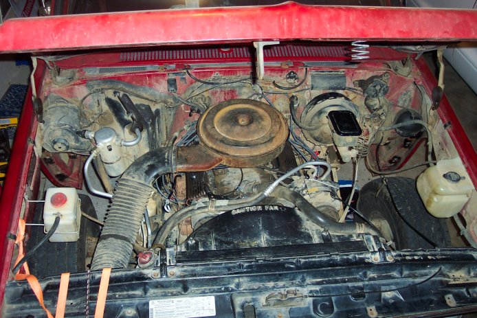

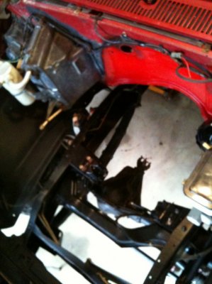

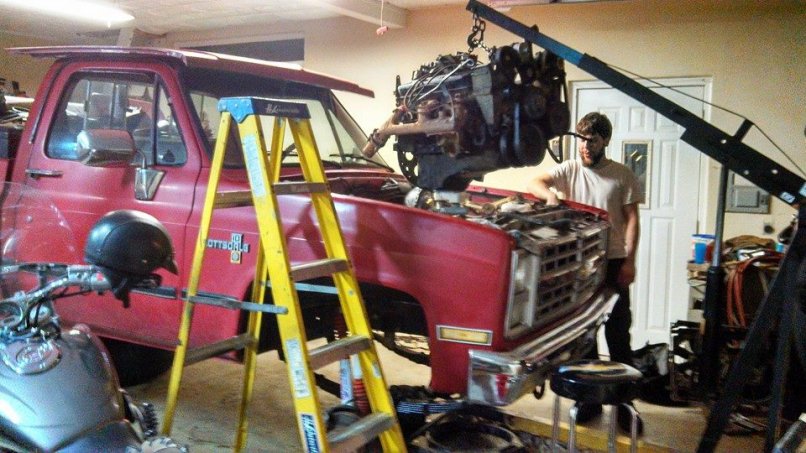

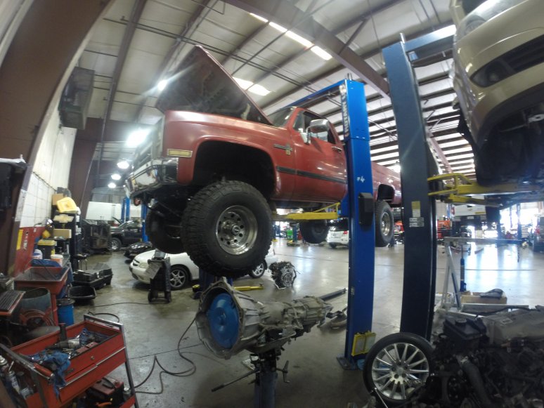

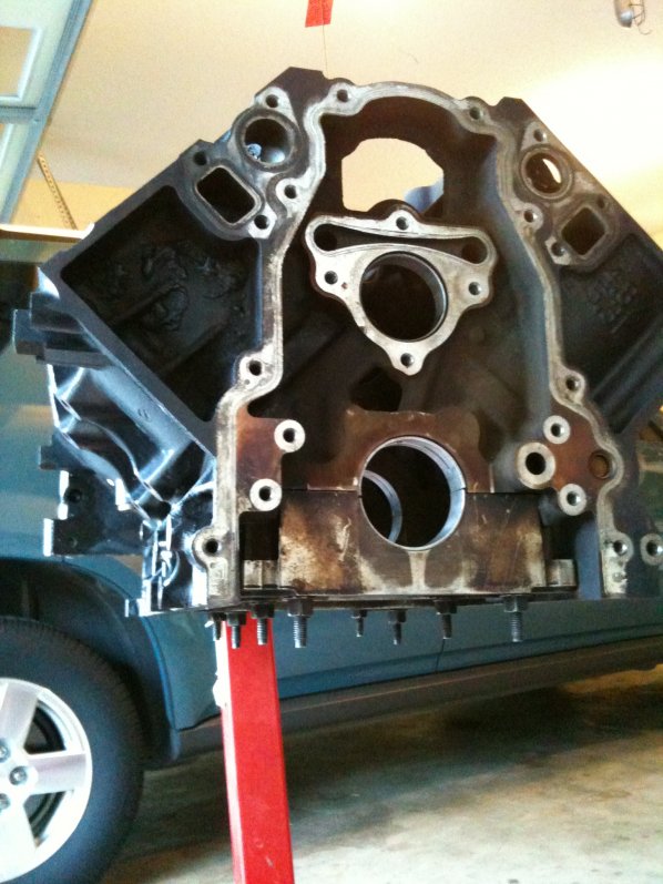

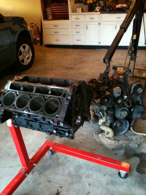

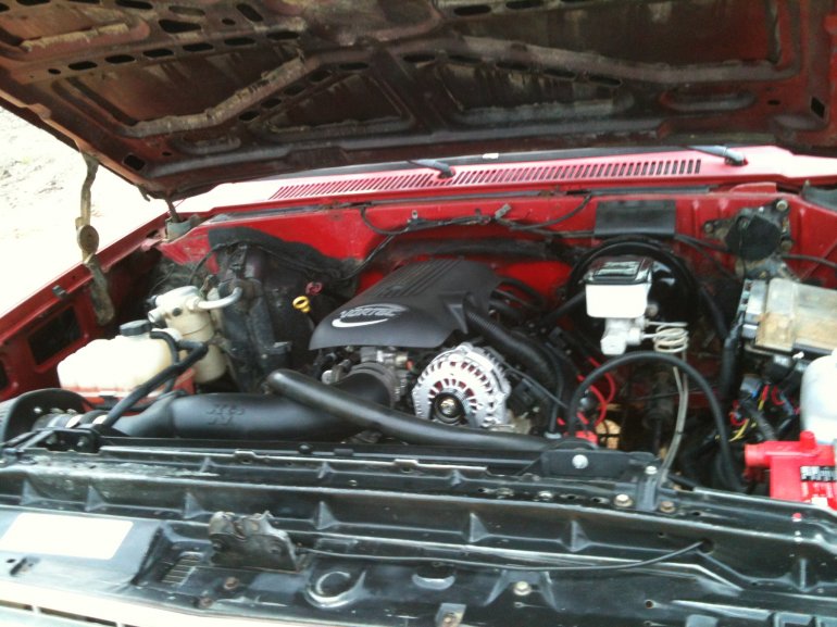

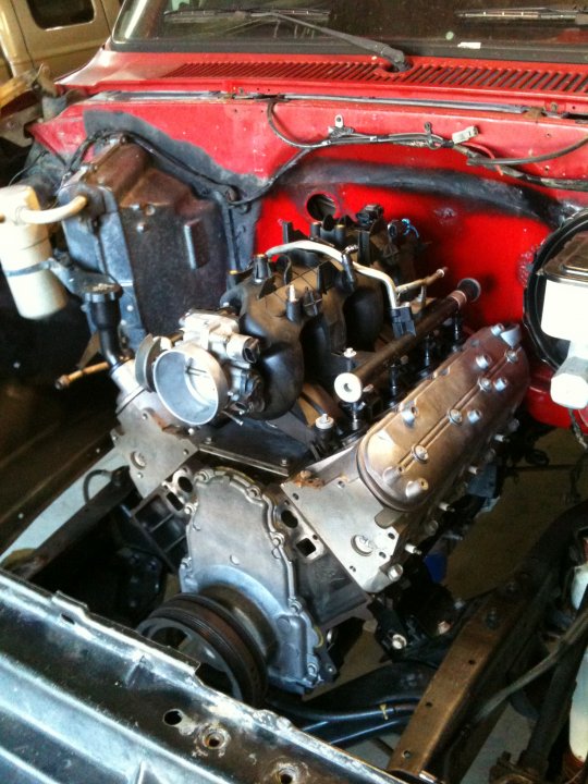

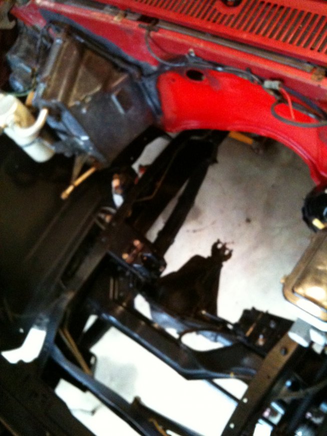

Realized i didnt post many pix of the actual swap so here we go:popcorn:
Dirty Dingo motor mount plates
2004 Tahoe LM7 5.3L
2010 Silverado 243 heads
2006 Silverado intake and rails
2006 Trailblazer 4l60e converted to 4x4 and got 6 bolt adapter fot NP208
Truly a Frankenmotor lol

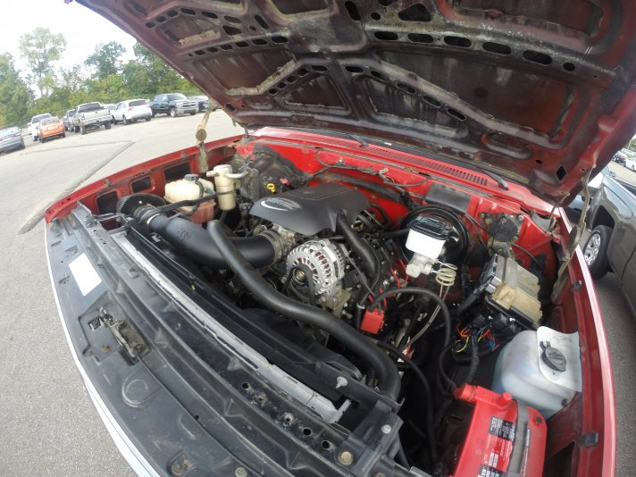

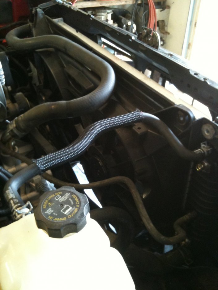

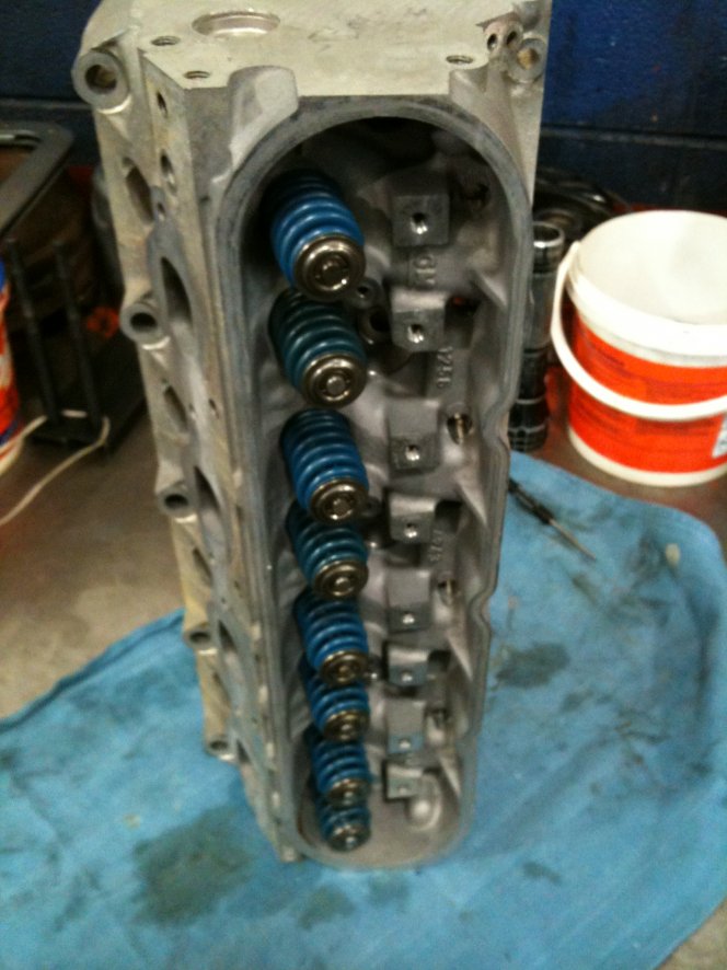

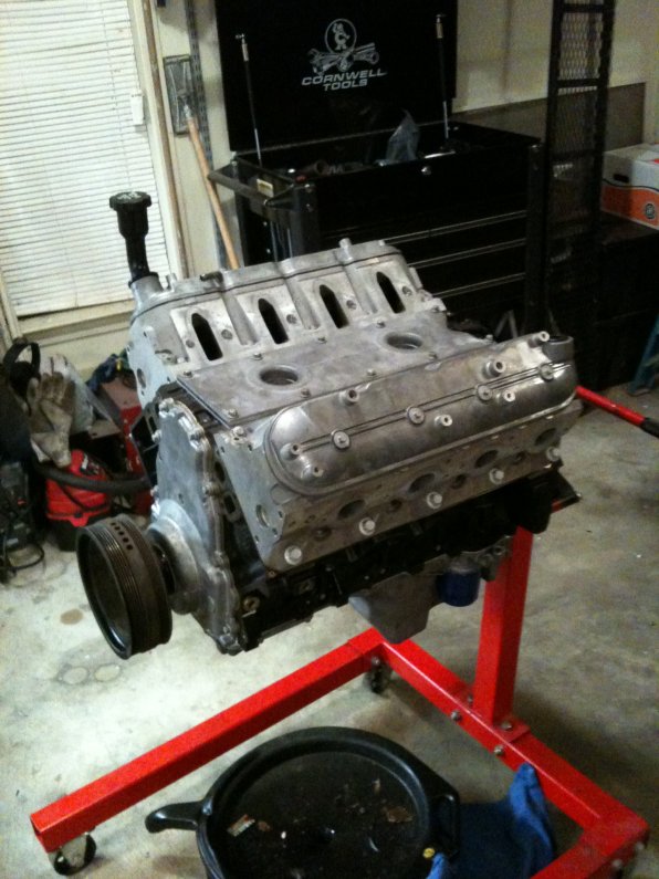

Built the LM7 from the block, Comp Cam and all new bearings/pistons. 243 heads shaved .030. LS6 springs/lifters/push rods.
05-06 chevy truck fans and radiator. ive seen some people chop the radiator support and get it to fit but i decided not to and run electric fans and still have plenty of room to easily change thermostat or the belt

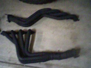

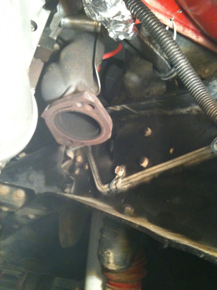

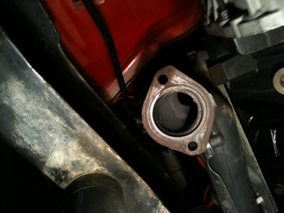

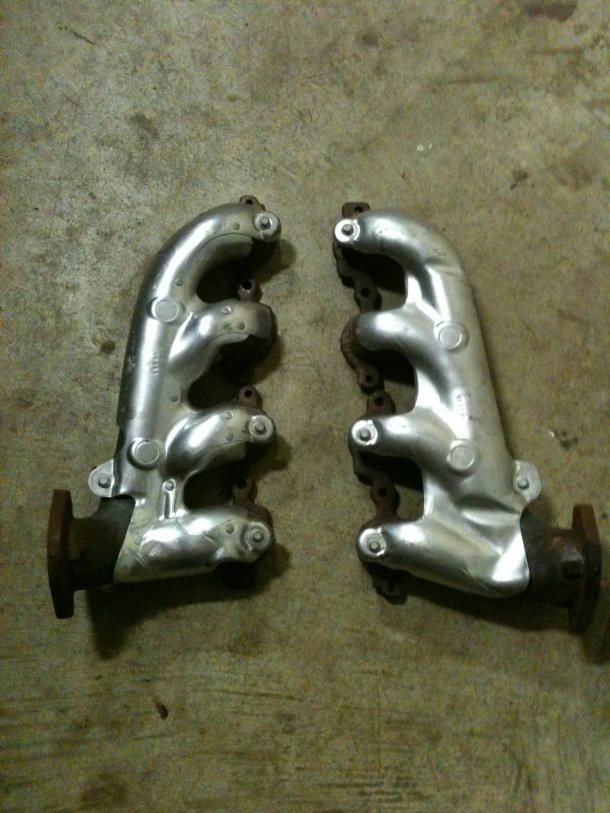

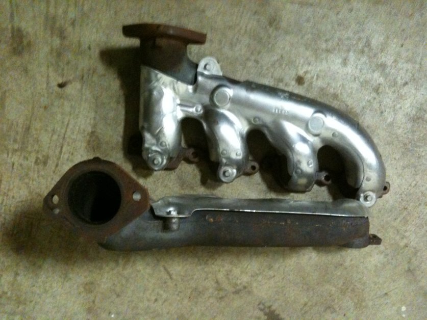

Ran the 2010 LS3 Camaro manifolds for a while then i found some Shoenfield 1302 headers that fit pretty well, they are for a 88-98 2wd LS swap i had to rework the collector angle on the drivers side cause of my automatic trans shifter, but i like the long tubers alot better and they fit pretty good

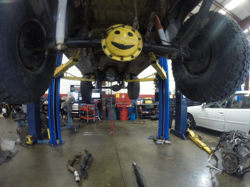

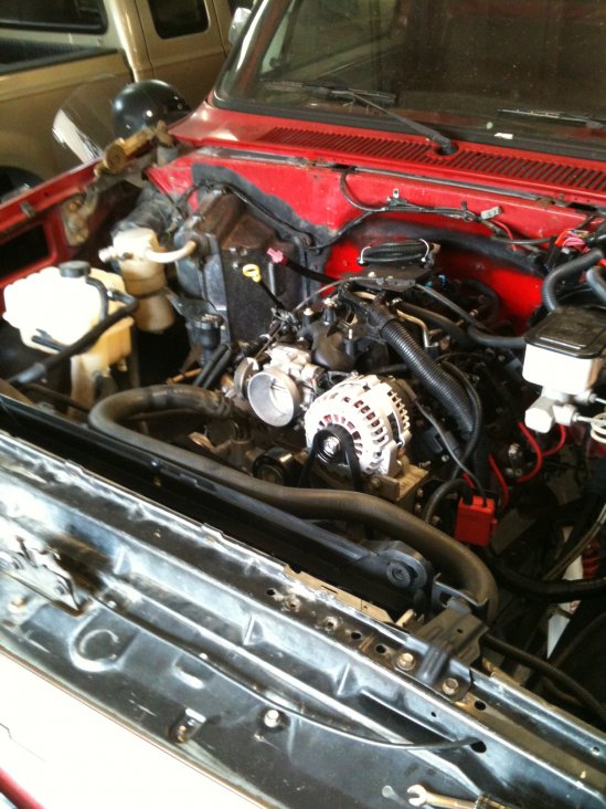

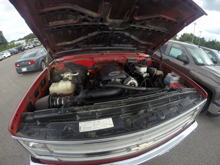

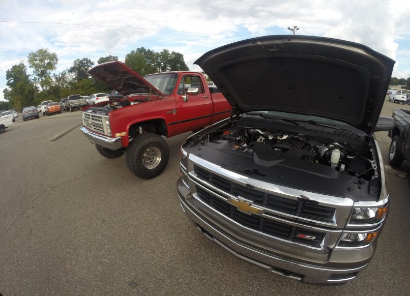

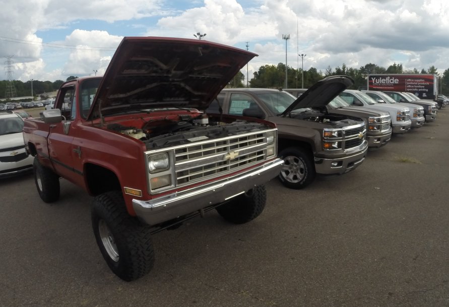

Final pix of engine bay, i installed long tube headers shortly after and took it to work and put in a PTC 2400 stall along with a B&M tranny cooler and braided lines, got some pix with the new 5.3 silverados, what do you like better old school or new school ? haha

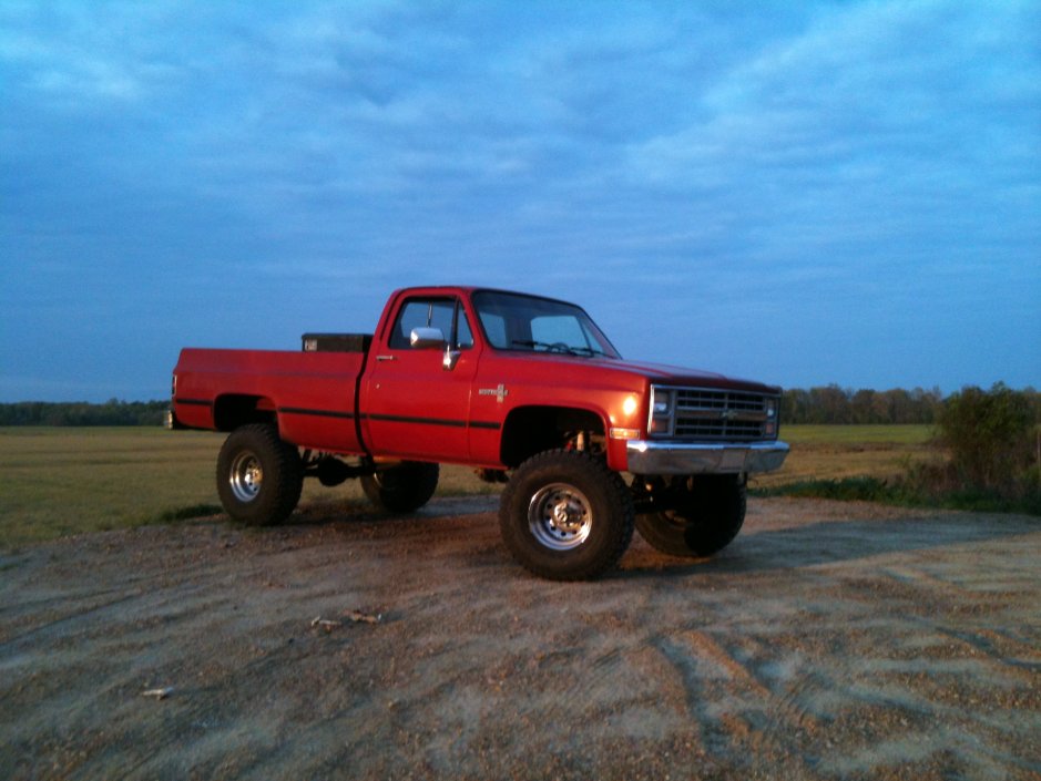

Come a long ways since i was 17 in 2008 !! and a couple wheelin pix from 2010

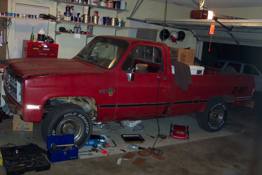

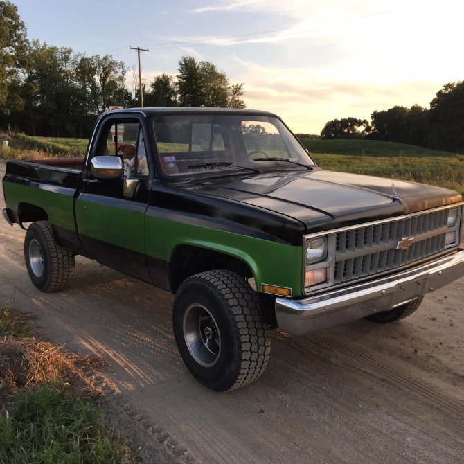

Here's a couple of mine in its current state
