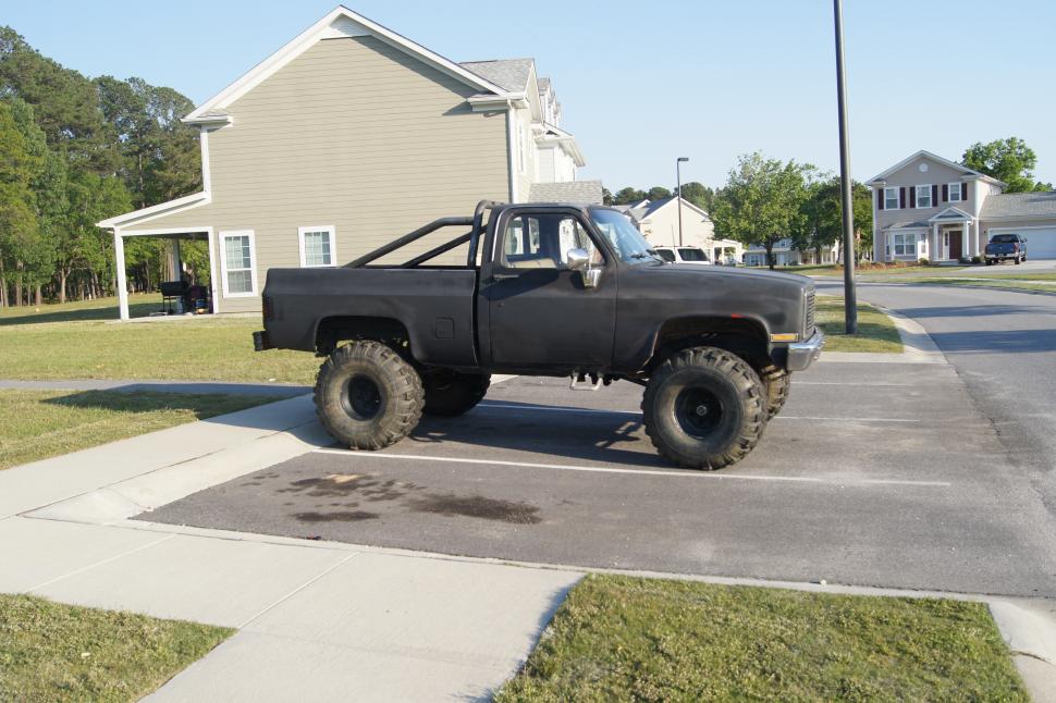

Here are some pics, finally got her back from the shop a month later. One issue i am having is the steering... I can steer all the way in one direction, and only like 1 turn in the other. The shop told me that an alignment shop could fix it, but can i do anything in the meantime to midi gate this, there is also some slop in the top of the wheel.

With that much lift if it has the stock steering box/draglink setup what you're describing is common. Your draglink probably looks like it is at a 45 degree angle. It needs to be as parallel to the ground as possible. Your options are:
4" raised steering arm
4" drop draglink
4" drop pitman arm
or
2wd steering box
crossover steering system
1st option would work good if you plan to ride it mostly on the road and not wheel it too hard. Also works best with 1/2 ton front axle which I assume that's what you got on your K10, a 10-bolt corporate front.
2nd option is pretty expensive but corrects your steering geometry and is much better offroad. However with a 10-bolt front you would have to have the passenger side knuckle top machined and drilled for a crossover steering arm, or you would have to buy a passenger side steering arm knuckle already machined for the steering arm.
Offroad design sells a bunch of the cossover steering parts, including the steering knuckle:
http://offroaddesign.com/catalog/Dana44crossover.htm
National Tire & Wheel sells the other steering parts if you wanna go that route:
http://www.ntwonline.com/Chevrolet-and-GMC-Steering-Arms-and-Components.html
I see they have the 8" steering arm but it is pretty expensive. Hope this helps!
