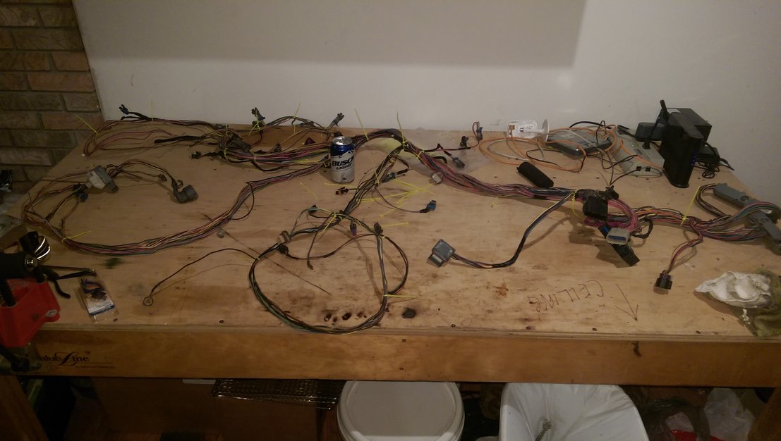

Finally gettin' serious with the harness. Currently 30 connectors.

Note to all doing their own harness.......label the wires as you take them off the engine! Nobody has a good picture of all the plugs! Not that I could find anyway. Might have to take pics of each and upload.
