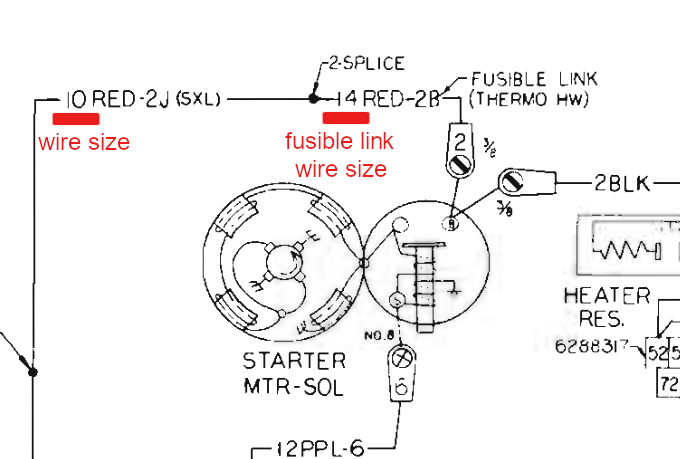

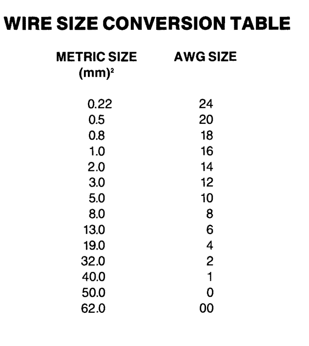

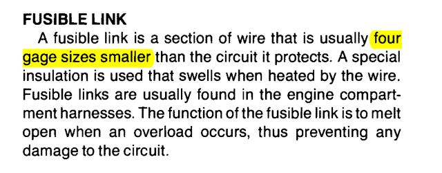

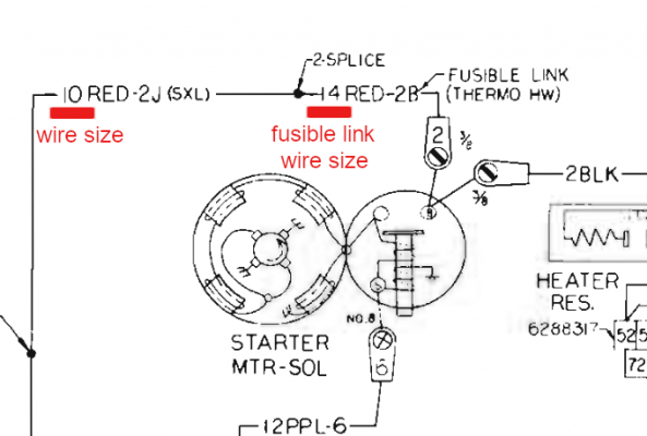

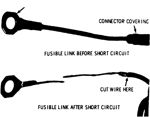

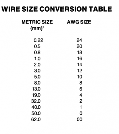

You can buy fusible links at auto stores or make your own out of fusible wire. (Fusible wire is a special type of wire)
Determine and use the wire size then add the fusible link (4 gage sizes smaller) You can look at the wiring diagrams for your year to see the original wiring sizes. Wire sizes are either metric or AWG (conversion chart attached)
Link to wiring diagrams
example of reading a 78 wire diagram is attached
