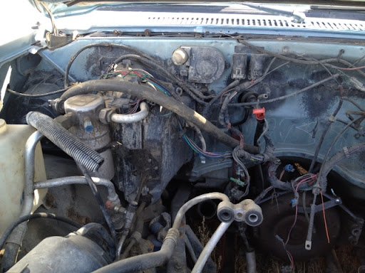

Hi again everyone!! Well after a year I’m finally back to working on my grandpas C30 I finally got settled into my new place and acquired a parts truck. My parts truck is an 84 K10, but don’t get too excited the frame is gone lol, but it appears to be a factory AC truck but the AC system is completely separate from the heater box. It’s made by Clardy Mfg. Co. part number 84-106341. And appears to be a stand alone unit. But my question is could I find a compressor and condenser and throw this setup in my c30?? Has anyone ever seen these? I’m not having much luck doing a google search. But it has an evaporator coil inside the vents in the dash and then a separate blower motor for the AC under the dash. The truck has the standard non AC heater box/ blower motor too. Anyways thanks in advance, I’m hoping someone on here has at least seen these before because I am stumped.

That’s aftermarket AC looks like to me.

Yep, aftermarket AC. Factory AC with have the unit that looks like this in the engine compartment. The factory HVAC selector will also have settings for MAX, Bi-Level, and vent.
