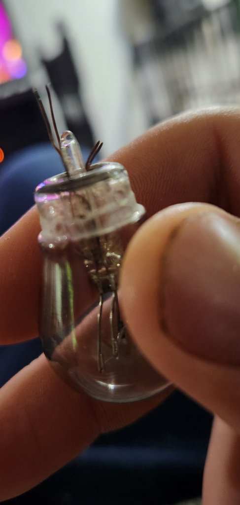

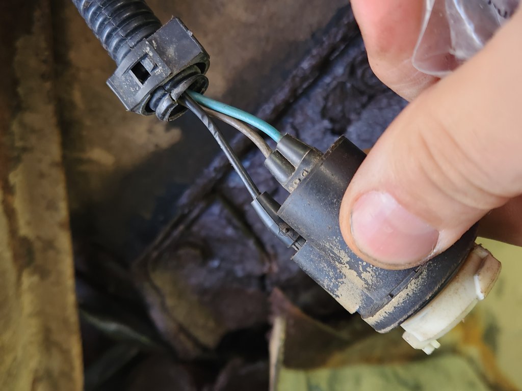

I bought new housings for my bumper fog lamps. Install was ok, (you have to mess around with the bumper otherwise they won't sit right) But anyways, that's besides the point. One lamps was burnt out.
Ok no biggie, here it comes, I pulled and pulled on it thinking geez she's corroded in there and then ripped the bulb out. But its not one of those replaceable bulbs like the taillights.... oh no. So it's broken. ( see pics).
Here's the questions now, what can I do about this, buy a new socket/plug and wire it in? Or.... I don't believe i can fix this current one...I can really take it apart, i pulled (gently this time,) on the wires to see if they can pull out of the socket but, no joy
Any ideas or help is appreciated.
Its a 3 wore socket/plug, and dual filament bulb.
Your removal method was wrong. 1157 bulbs do not just pull out like newer lamps. You push the bulb in, turn CCW and then it comes out.
That bulb socket is probably still okay. Just need to remove the rest of the old bulb.
7,864
14,012
Auburn, Washington
Those are your turn signals. Dig the old bulb base out of it, soak it in some Coca Cola, coat a new bulb with dielectric and install.
Or buy a new socket if there’s something wrong with it.

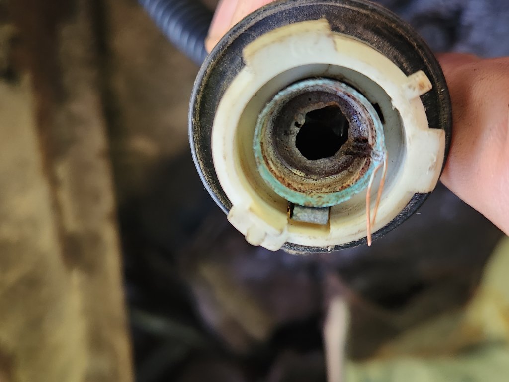

Passenger side still works fine. Just dim.
Driver side wasn't working so that is the ineni brutalized.
The pic with the socket, you can see a piece of the copper wire, and same here with the bulb. I'm gonna head to napa and just buy some new ones. Replace both i suppose

You didn't take the bulb out right or the base was just siezed in the socket. You can most likely reach in with needle nose,grip the bulb base with is still in the socket push in and turn counter clockwise 90 degrees,then pull out. See the 2 nubs? They need to be lined up with the grooves in the socket.The nubs keep the bulb in place.
7,864
14,012
Auburn, Washington
Thanks @Ricko1966. Still not certain if the OP understands that part of his light bulb is stuck in the socket still.
This is not an uncommon occurrence with old/corroded lights of this style.

Nah i get what he's saying, ive dealt with the turn to pop out bulbs before. Pic shows its pretty corroded in there. If that's the case, I'll jist buy some bran new 1157 and replace em both.
