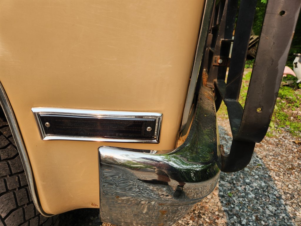

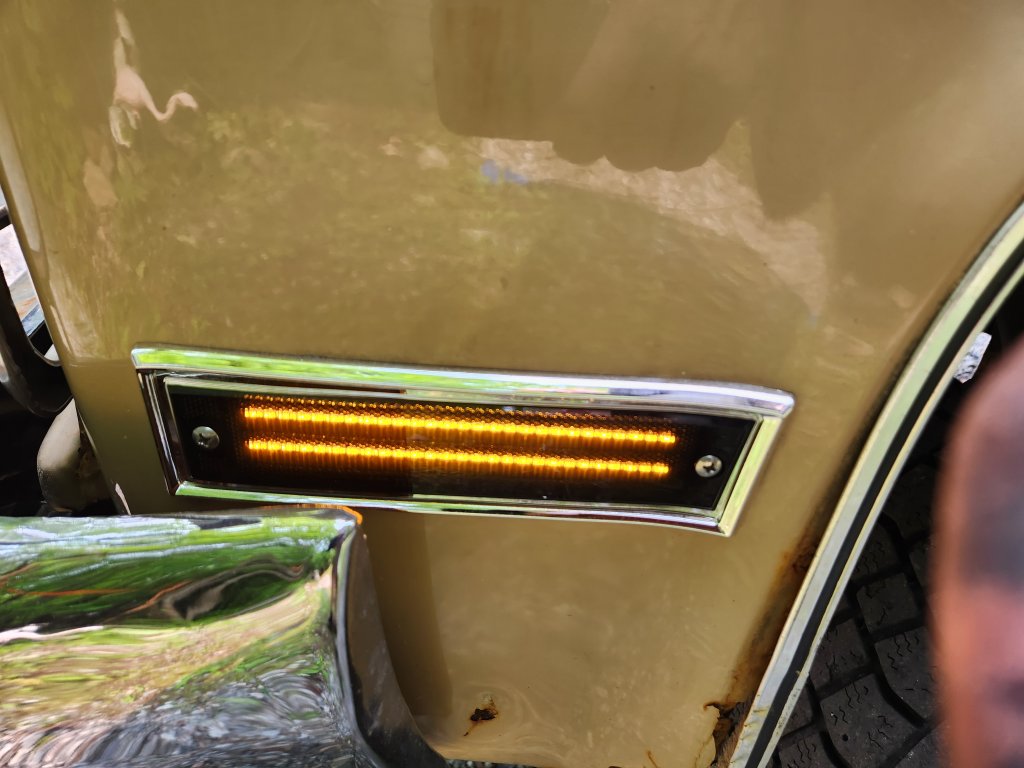

My bad i should've specified these are made for 81 to 91 squarebodies according to amazon
Bestview LED Side Marker Lights Compatible with 1981-1991 Chevy C10 C20 C30 GMC C1500 C2500 Suburban Blazer Jimmy, Driver & Passenger Side, Smoked Lens https://a.co/d/dSnUvBo
There's a link here, I copied it but looks kinda weird. But if it doesnt work google 81 to 91 led side marker lights.
There's clear lens, smoked lens, and white light.
I opted for smoke lens.
As far as what your saying using turn signal at same time as running lights. These are great. Literally, unscrew old lens, pop bulb out the LED is already hooked in the new lens, slide the adapter into truck wire harness and re installed.
But back to the issues you're mentioning, I just did a walk around of all my lights, (had to replace license plate bulb assembly, and go creative with my ground.) So, I did a walk around, lights on. Left turn signal, right turn signal, 4 ways, everything is working as it should.
Here's pics on on n off for my marker lights
Then when turn signal applied they just blink. Non of that ugly sequential flickering.
