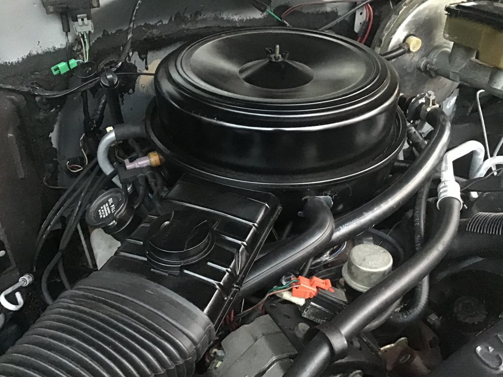

Will caution you, if the vehicle has a 4 port TVS on top of the thermostat housing it will need the smaller diameter air cleaner pictured above. Ask me how I know.

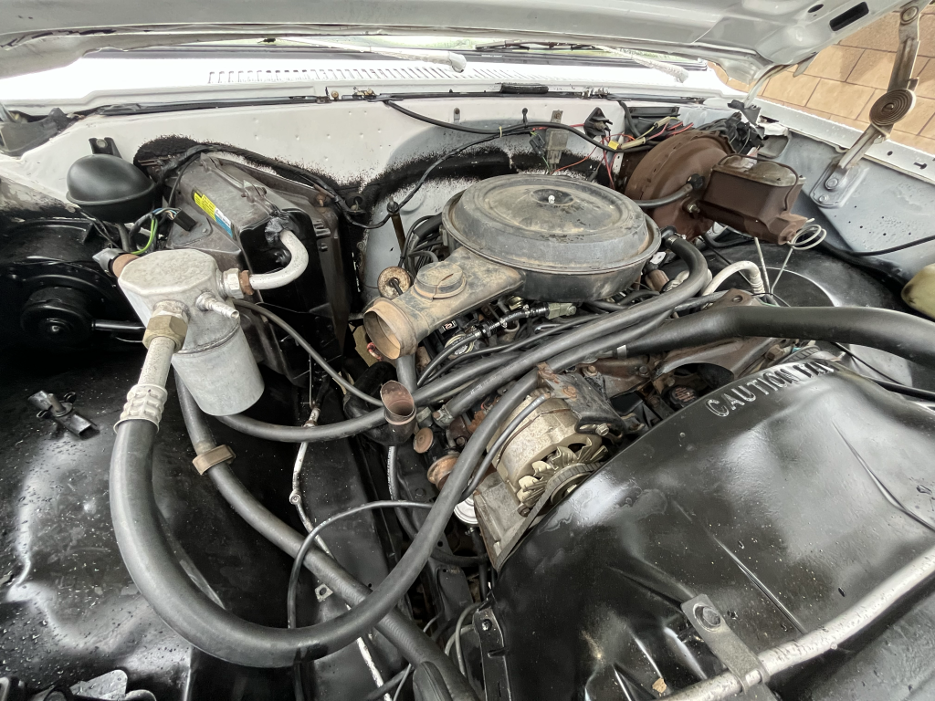

Under my hood...

I mean do all Heavy Duty C20s and K20s from 1981-1986 have the same Air Clearers with different emission labels on them depending if the truck was sold in California or not, or are the Air Cleaners different based on what engine came on?
forgive my ignorance...

My 81 K20 is same as top one pictured, 85 K20 has one like you posted, both 350's. They were originally non-floater, so lighter duty. Can't answer the question directly but would guess GVW, year, California emissions, dual or single tank might all play into what was installed.
