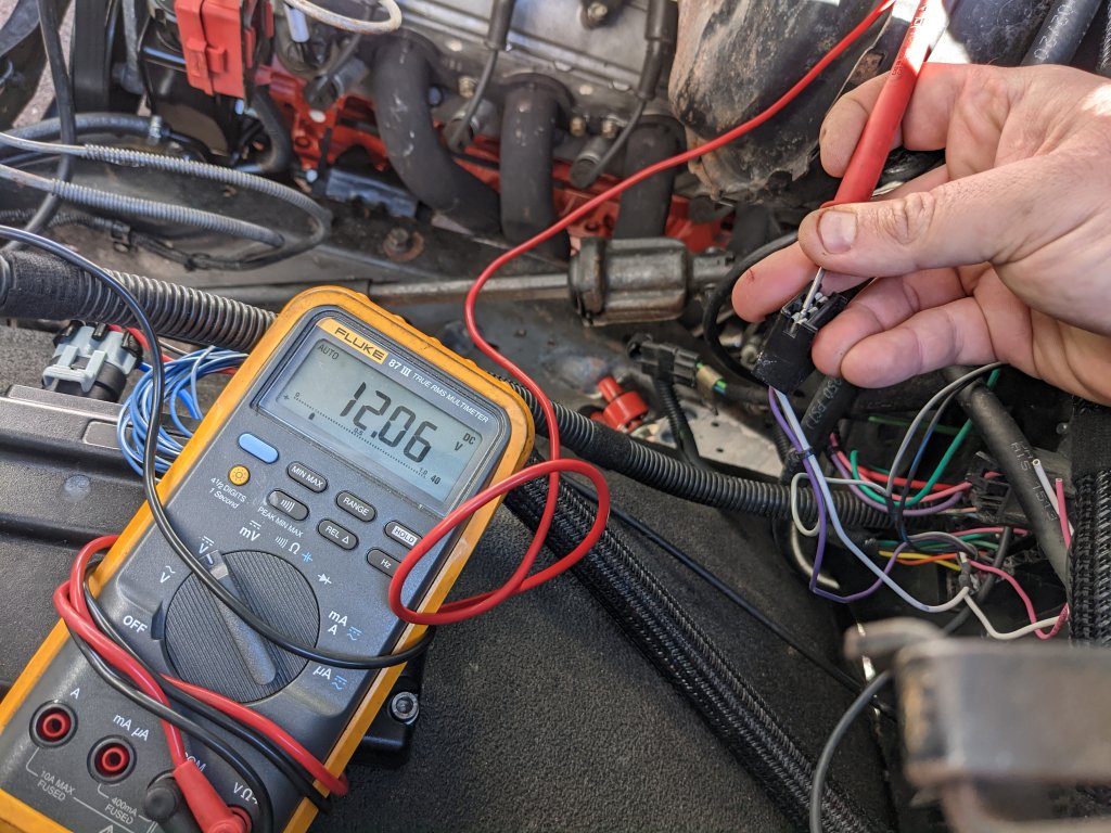

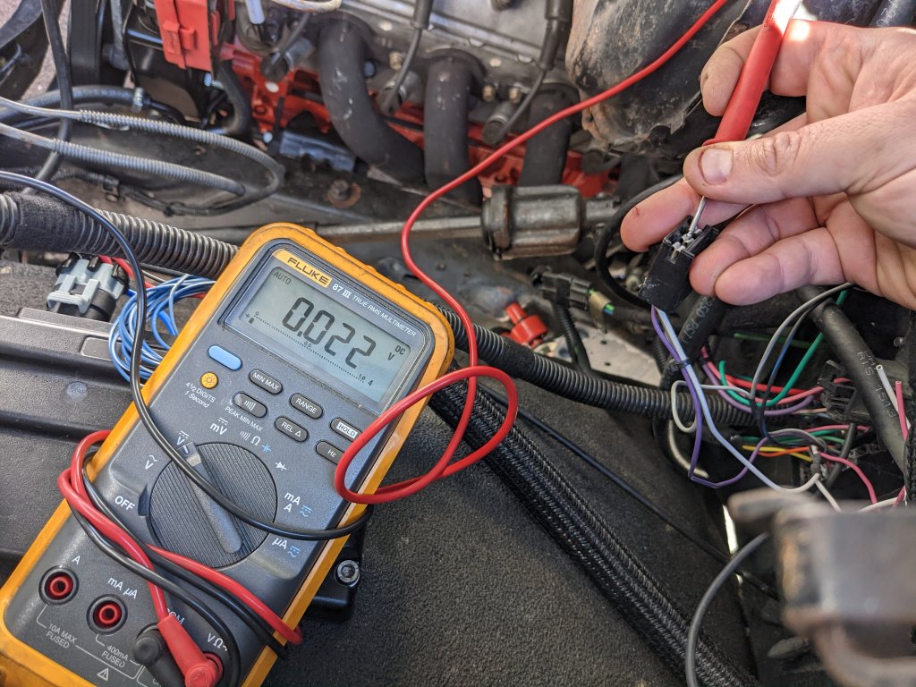

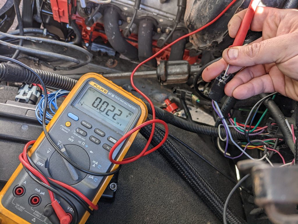

I'm not sure how the wipers work at all. The only way I could see the motor working off of 0.022V is if there are relays inside the motor housing.
This is with ignition power.

Wiper switch in low.

Wiper switch in high (the only speed that works).

Anyway, it looks to me like its binding or something is interupting the power and ground circuit because they arent constant they are jerking and slowing down very fast, I would check those wire connections and provide a nice new ground straight to battery and bypass switched power with a junction block wire or cable and see what happens. If it gets better, you have an idea. if it doesnt, it tells me its internal to the assembly or the linkages. if you put the wipers in up position where they stand off the windshield, do they move faster

Should I be getting 12 volts on the 2nd and 3rd pins?

purple is 12v for high. gray is 12v for low. I'd also check the connections at the base of the steering column where the switch plugs into the harness and see if they match what has voltages under the hood.
