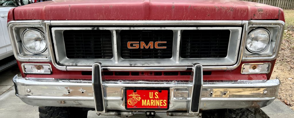

Necro thread but 110% the grills from 73-74 and 75-76 GMC’s WILL NOT interchange without new brackets and technically a core support. The 73-74 are deep dish and will hit the factory brackets on a 75 and later truck. I just put a 73-74 grill in my 76 knowing of this issue and bought the brackets from lmc and then made my own for the part way in from each side brackets.
Ben

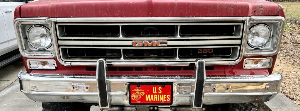

When I picked up my ‘75 K25 it had a 73-74 grill in it. It was zip tied on because the mounting holes were not even close to lining up and it had a weird looking gap around it. Found a ‘75 on Marketplace and everything lines up and mounts properly.
