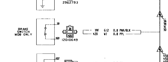

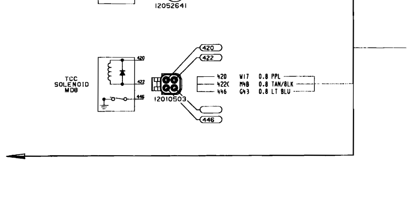

Just installed new plug in 700r4 old one was toast. 87 Chevy v10 tbi. Saw the pink/black and the blue wire and I wired those right in, missing original wiring for the purple, any advice on where to look and what it's purpose is? I'm trying to clean up PO shoddy wiring, any help appreciated thanks !
