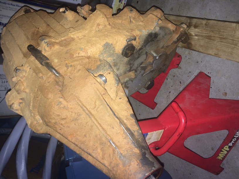

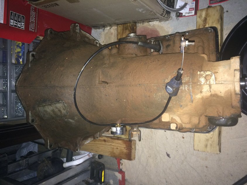

Alright well I gots some good news. I've secured the funds to buy a rebuilt transmission. I dropped the transfer case yesterday and dropped the transmission today. 1st time I've ever done anything this intensive to a vehicle so I'm feeling pretty pround. Unfortunately when I set up the transfer case- I thought I had set it level enough to where it wouldn't leak because I didn't drain it. Yeah well that didn't happen. ALL of the fluid leaked out ALL over my garage floor. That was fun cleaning up. Now I got sand in my garage to soak up any left over fluid. But yeah, I'm feeling pretty good. What would y'all say is a good/ decent price for a rebuilt transmission. Nothing to drastic or anything like that. I'm not looking for a racing trans with upgraded planetary gears and whatnot. Just a "stock" trans...???

No biggie on the fluid leaking out of the Transfer Case. It probably could use a fluid change anyway. IIRC, it takes Auto Trans fluid too.
Price on a 700r4 is very hard to say since there are so many variables. One the builder and their charges, the biggest variable is what all they upgrade or update in the transmission and depending on how many hard parts are broke inside. The spectrum could be from $800-$1200 for a bench job since you're doing the R&R yourself. Does your price include a new converter with the build or do you need to buy one of those yourself? Is a NEW TV cable included? Not a bad idea since they do tend to stretch after time and the TV cable being set propely is very critical on a 700r4 and if not set right, it'll cook that transmission within a couple hundred miles or a day.
In fact, if this builder is any kind of reputable and offering a warranty, he should be happy as hell if you take it by to him after you get it installed and let him check the TV cable adjustment and installation. That covers his ass too so he don't have a warranty transmission due to a bad TV cable and/or adjustment.
