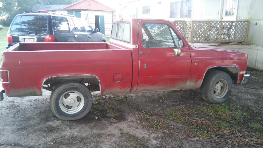

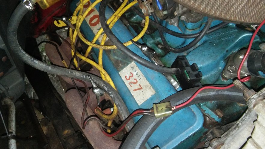

been searching for a 80s model swb square body for many years..well this was my lucky year 3 days ago i was delivered my very own 84 Chevy c10 (looks abused but no rust) truck as my 34th birthday from my dad. we bought the truck for strictly the body to build on and didn't think to check under hood because we were gonna build an engine anyways. well much to our surprise it wasn't a 350 it was a 327 210hp engine from what i decoded numbers to be a 64-67 Chevy II nova engine. so now instead of a 350 build it is now a 327 build. Now here comes part where i need advice...i want to drive truck roughly 30 miles daily and build a engine with some kick to it. it has a turbo 350 so would need over drive any recommendations? ive heard put a 283 crank and make a 302.i was thinking on a mild cam and some updated heads to start ..i can search all day problem is i dont know what to apply to my build and not too because everyone is different. please give me some positive insight or opinions. thanks

I'd keep that 327 just like it is and go with it. That will be a small journal 327 with a forged steel crank. All small journal motors were forged cranks. That small journal also cranks up the rpms real quick and begs for more. I've spun one of those making power to 6800 rpm before and could rap it to 7500 rpm without issues on the bottom end. Just be sure to have it nicely balanced, moly rod bolts, shot peened rods and such if you intend to turn it that hard. Also, obviously big cam and springs will be needed to get it to turn that kind of rpm and not float the valves. It's a tough as nails bottom end, so a mild cam and pulling hard til 5500-6000 rpm is not much of a problem.

Ditto to this. I had one of those with a mild cam and that motor was lots of fun. And it did wind up fast.

While this is all true, the 64-67 327 is even more exceptional being the small journal forged crank engine. And all the hype and talk about high nickel block BS, it's absolutely true for the old small journal motors. They're just so hard to kill. I wouldn't mind trying a small journal engine with some vortec heads. I think it would be a screaming bitch. :shrug:

Also, pretty sure that's a truck engine based on the color, decal and horsepower rating. The 4bbl 283 was rated at 220 in cars and I think all the basic passenger car 327's in those years were rated at 275. The later large journal car motor was rated at 235.

There were different variants. Whether it has the Power Pak or Fuelie aka Double Hump heads, 2 or 4bbl carb.

That block should be worth money in a Nova , it's rare because of the recessed oil filter mount and unique to Novas only !!
I'd sell it on StevesNovasite.com for good cash and use the extra to fund the new build, and I'd go to a newer TBI or Vortec roller block with vortec heads.
