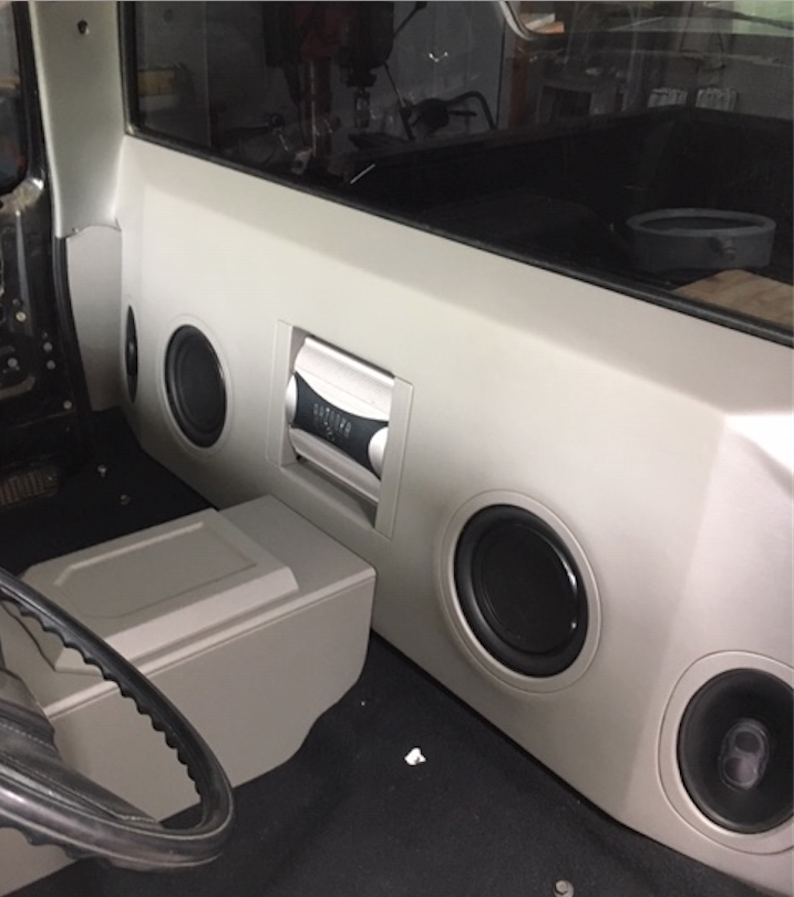

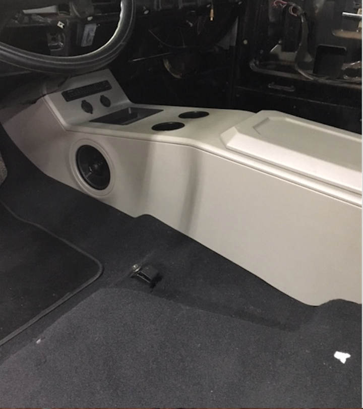

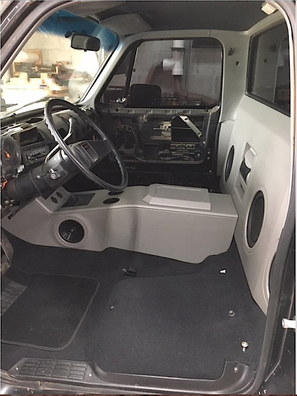

Here's how I put my system together, 6X9's facing out instead of in toward the seat with 6.5's in the center console. Also added a 4X10 in the center dash. The surround sound turned out great.
That looks fantastic! And gives me ideas for mine whenever I redo the interior. The plan all along has been buckets and a custom console
That indeed looks fantastic... Makes me wish I would have sourced some bucket seats for my build, too late now.
I absolutely love how you tied the speaker box into the B pillar trim

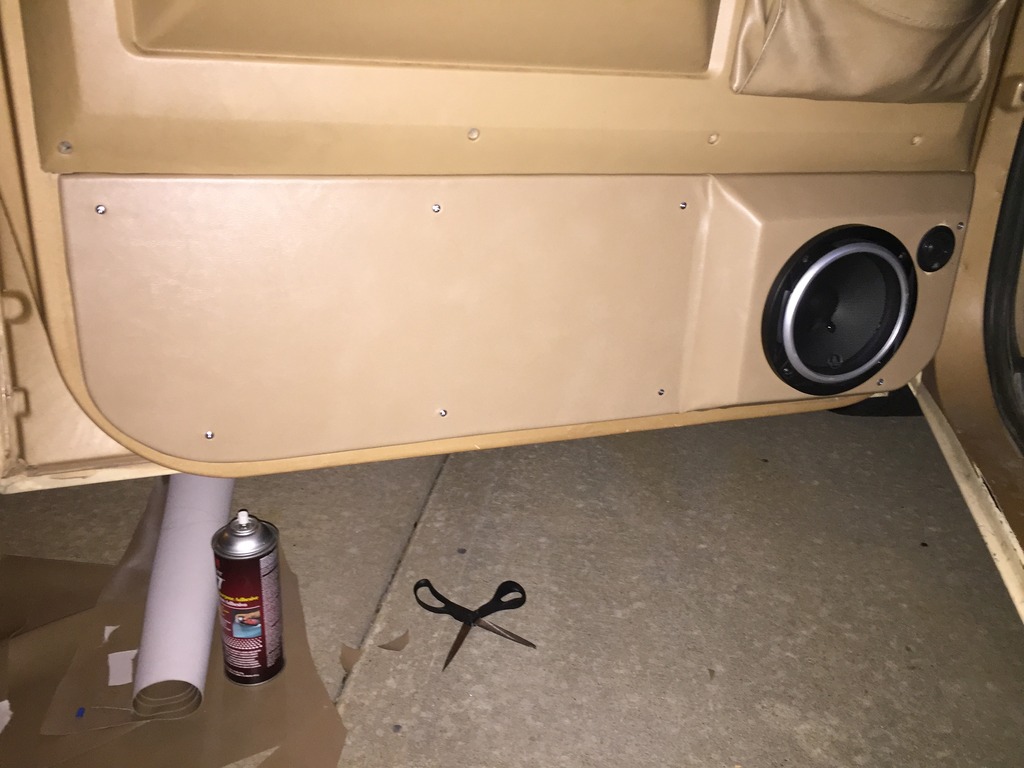

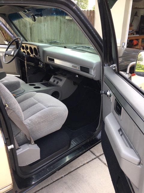

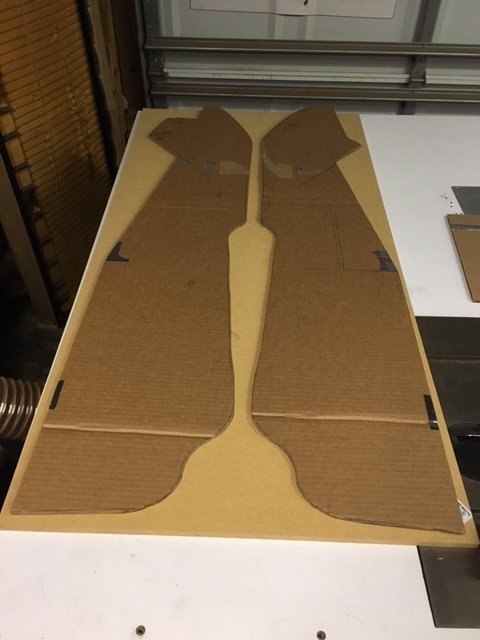

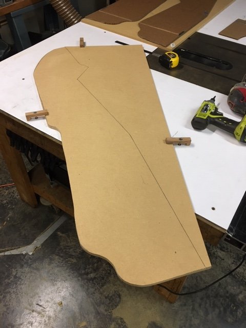

Thanks for the kind word's, making the templates for every thing to fit nice and tight was most of the work. I basically built the box and console out of card board first then used the car board as templates.I kept the side templates I made for the console if anyone would like a copy. I got the buckets out of a 1999 Suburban.
