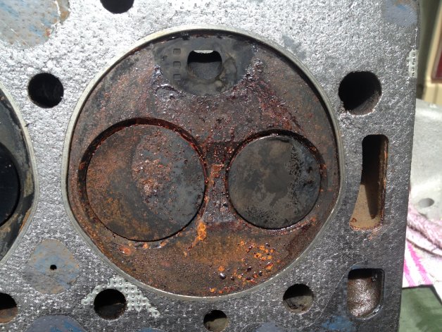

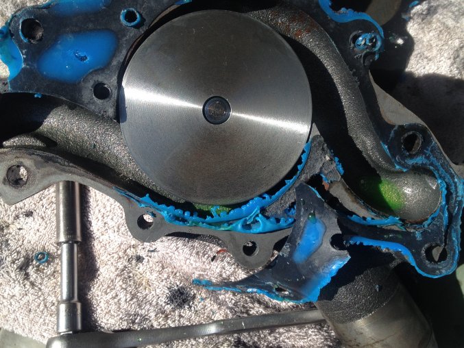

Think I found my problem.

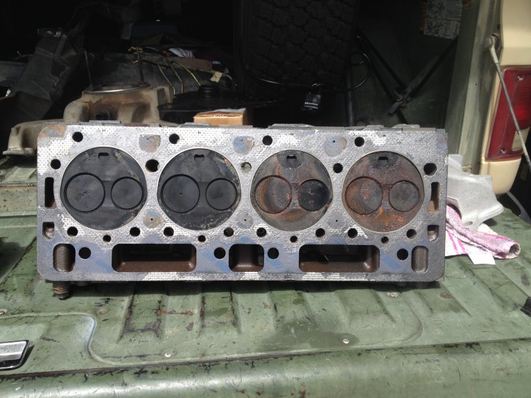

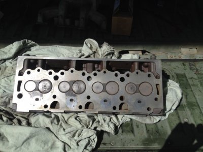

:banghead: Head gaskets were good it turns out. Now I need to figure out how to clean up the other set of heads I have. These are the new ones. I have cleaned up one, the other is still a bit rusty. Should I get these professionally cleaned up? Thanks

I probably wouldn't pay to get them cleaned up if it's just that combustion chamber. You could probably clean that up pretty good yourself without too much trouble.

Thanks guys. What I'm using to clean the heads is just a straight razor blade and some very fine steel wool. I'll be getting some brake cleaner to help get everything squeaky clean before reassembling. Only thing i'm worried about with these new heads is that the valves are rusted shut (if you cant tell I am pretty clueless when it comes to cylinder heads). Also since these heads came with stainless steel gaskets i'm going to be looking into getting some of those. I have regular fel-pro ones, time to do some research and see what makes them different.

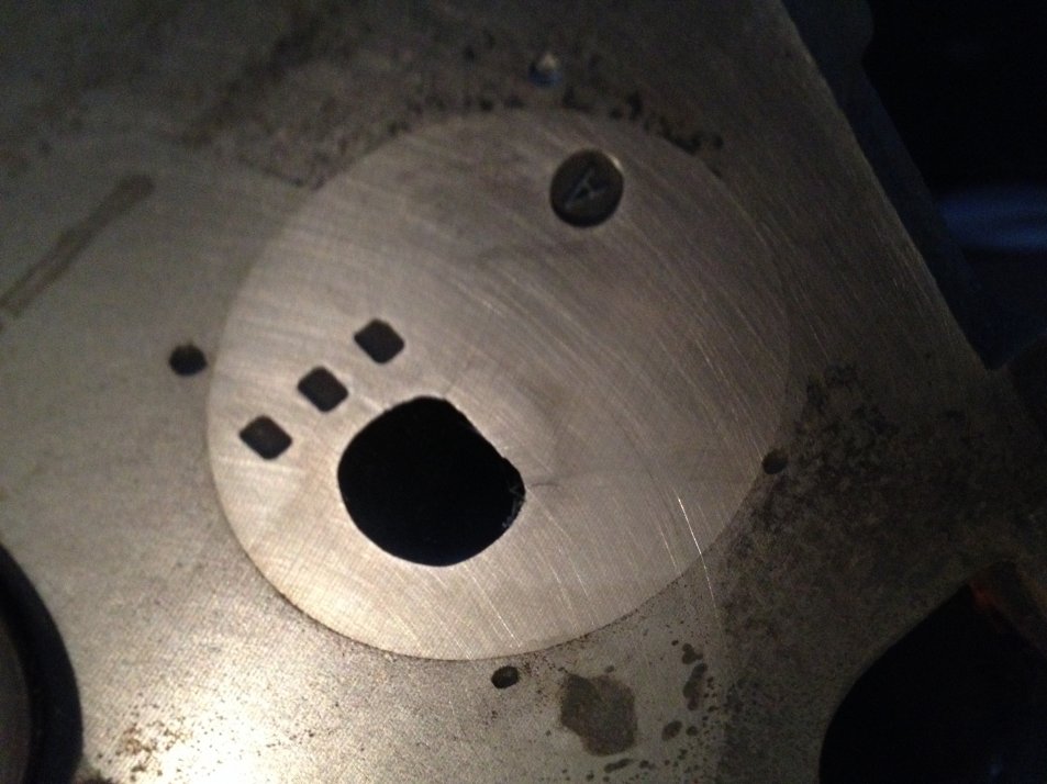

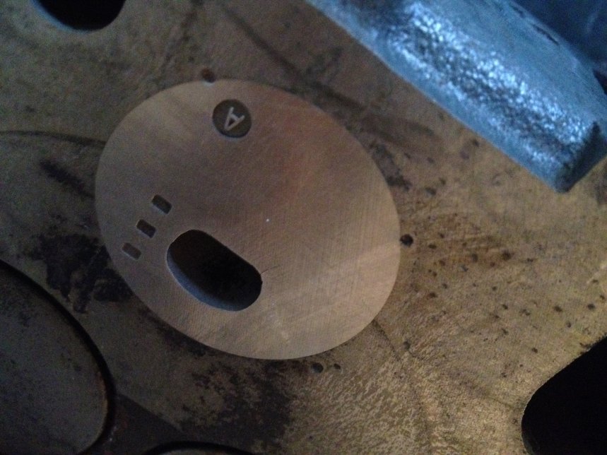

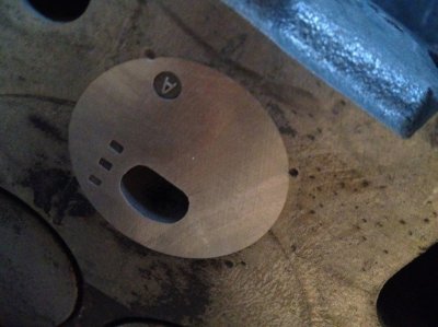

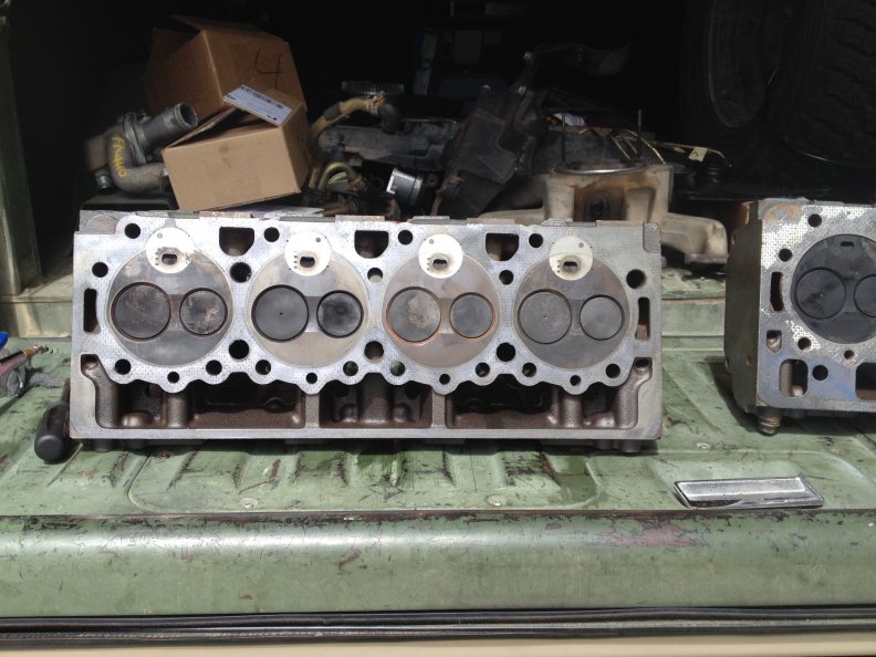

Getting closer to buttoning everything back up. Heads are cleaned up, still have a few spots to go over again. Bad news is my precups are cracked. I know its a common thing but one head is cracked more than the other and it's making me want to swap those out while everything is apart so I wont have to do this again.
