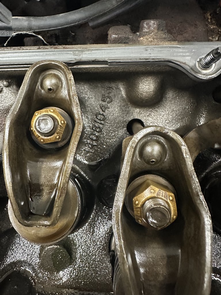

Howdy all!

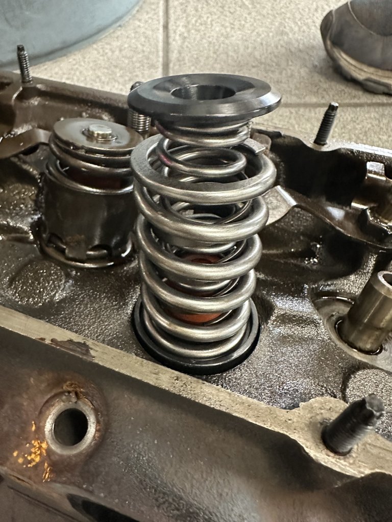

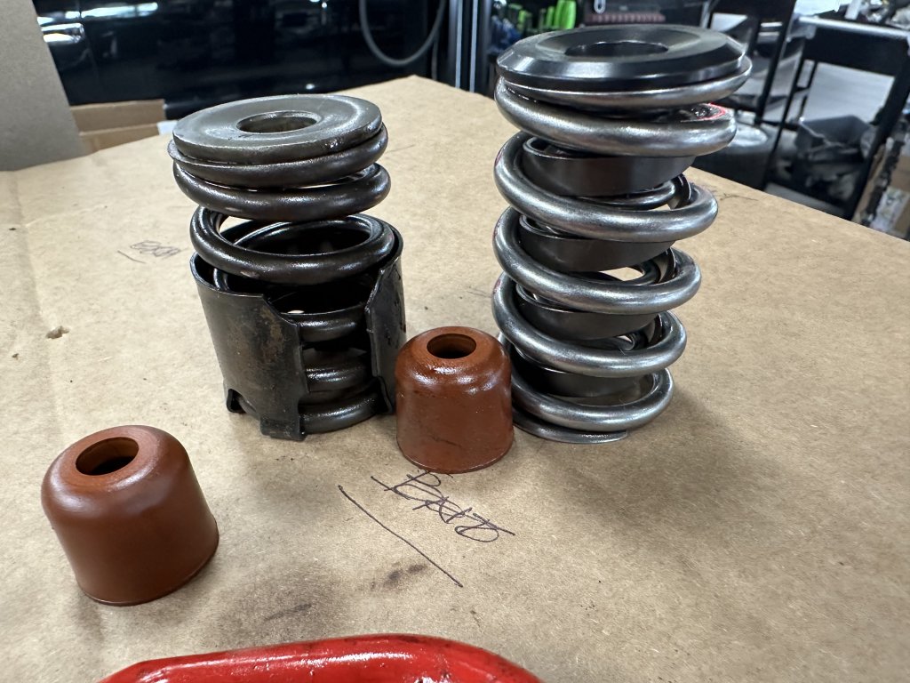

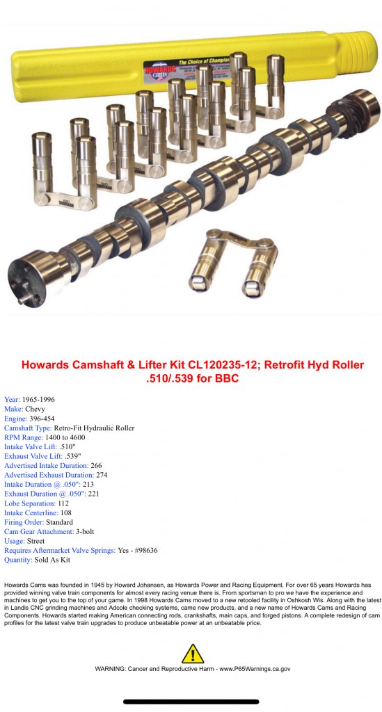

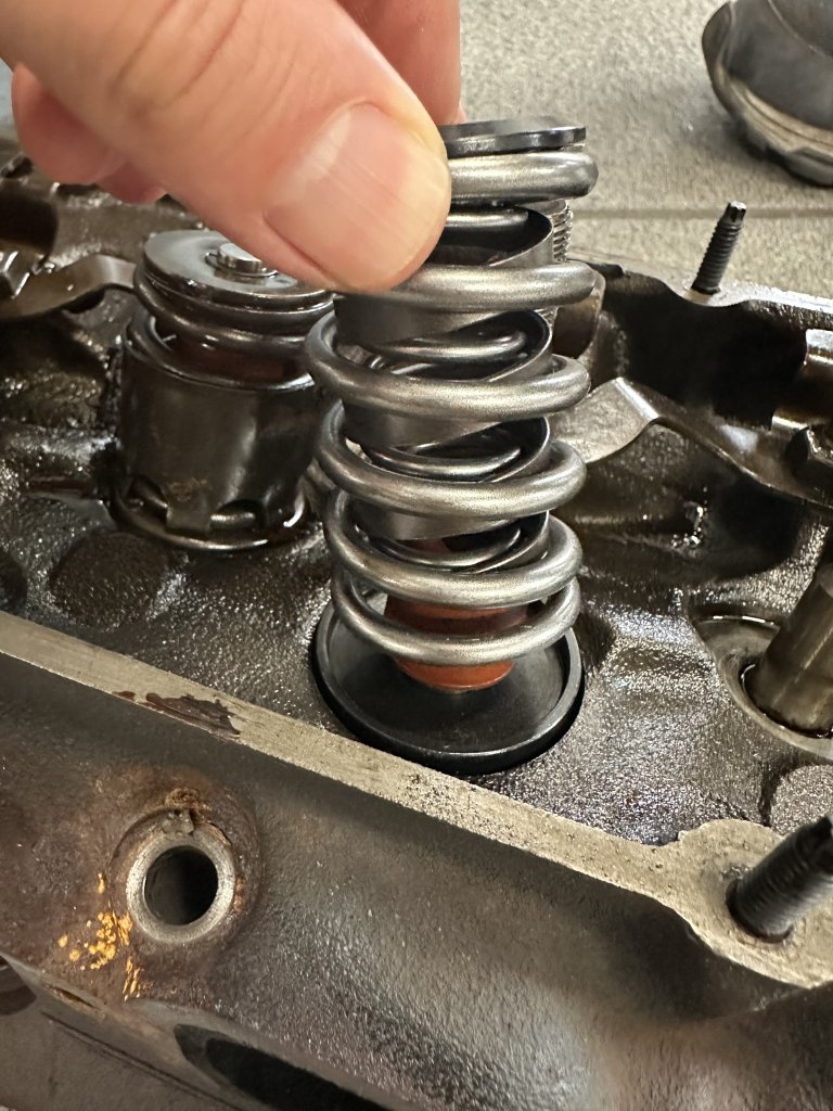

After much deliberation, I think I’ve chosen to go with a Howard’s roller cam set for my 85 454.

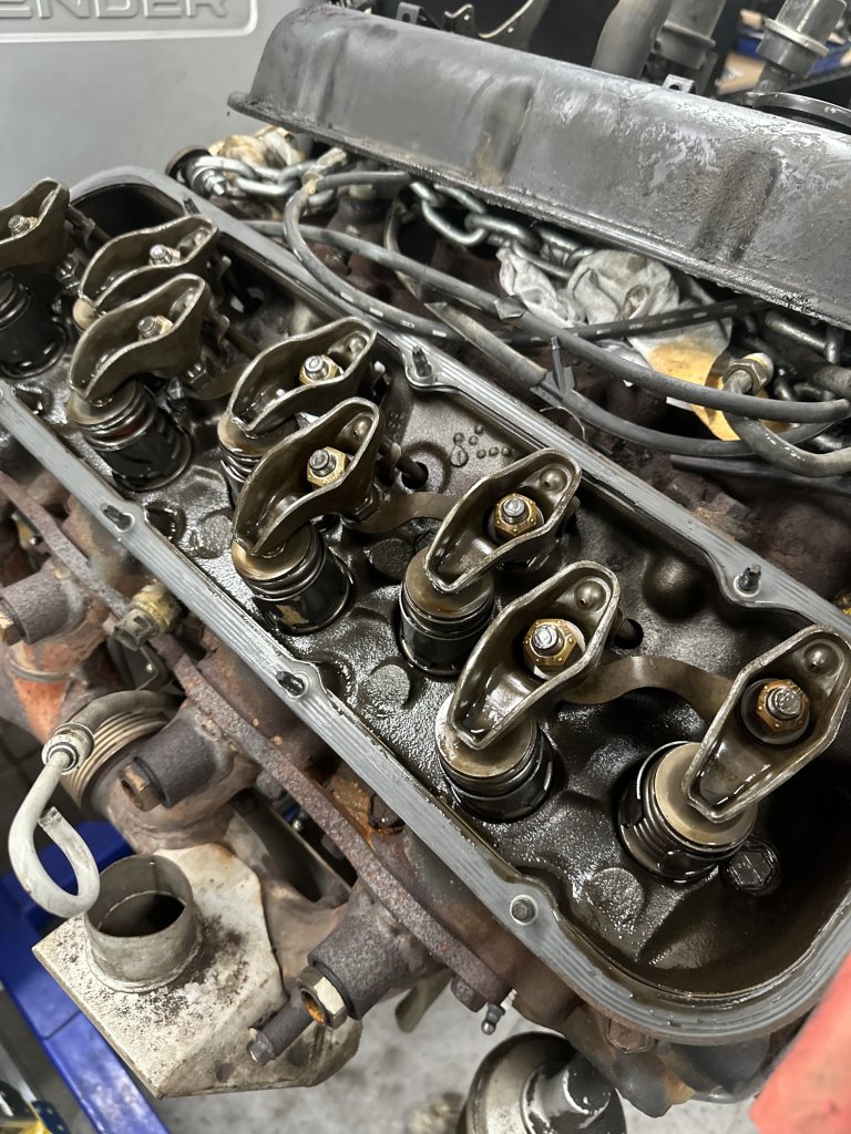

Howard’s recommends some springs so I’ll get those and then get the pushrods that fit. I would like to use factory rockers if possible. Thoughts?

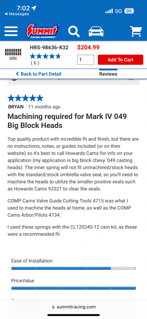

One note on summit is that someone mentioned having to machine something with the springs and definitely don’t want to deal with that.
