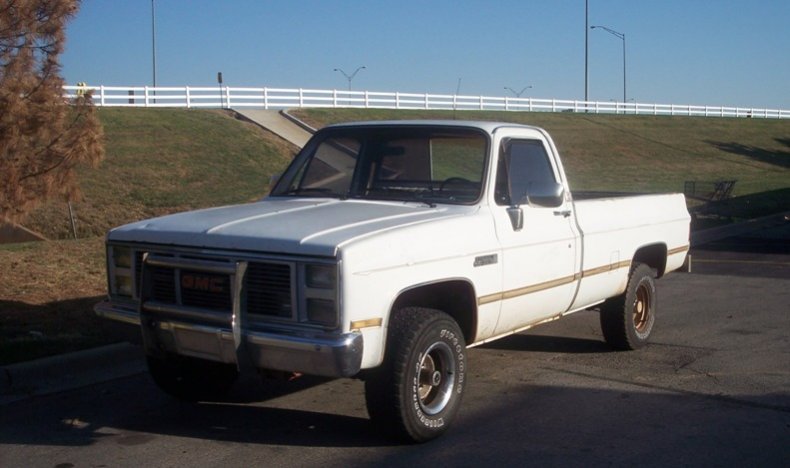

I don't think it's the wider rims that causing the rubbing. It appears to me, that it's the wheel offset.
Yep, if I have my way, this one will have 3/4 ton 2wd longer rear springs, front axle converter to 8 lug, and 14 b full float rear end on 16in OEM wheels and the 4in front lift springs and 2in blocks, so it might sit even a bit higher.

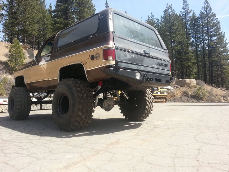

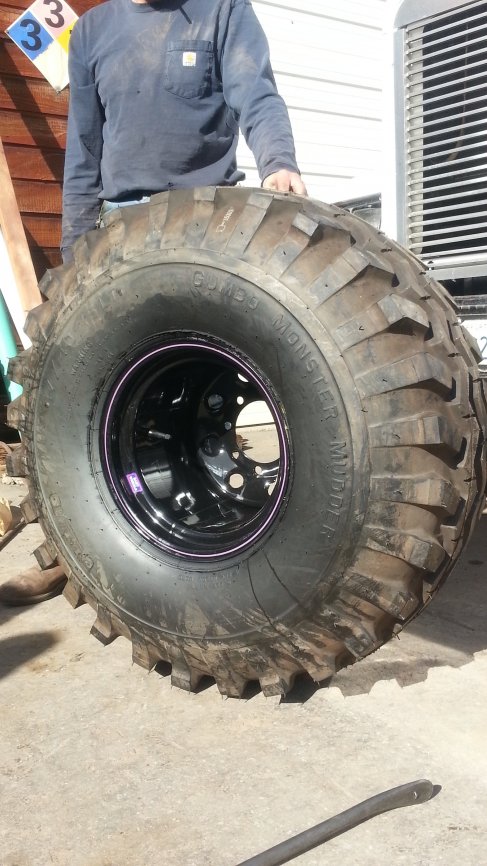

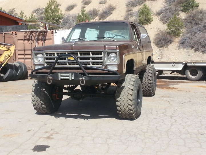

That truck has 12" wide wheels on it , (look at the tire bulged out) and with a 4" lift with 35's with 12 wide's they will hit for sure.You can get wheels in all different off sets but if you stay with a 4" back space (lets say) an 8" wide has 4" out , a 10" wide has 6" out and a 12" wide has 8" out so the wider the wheel the more chance of fender rub you have. You can get wheels with different offsets but still , a 12" wide wheel is a wide ass wheel. I like the look of wide wheels , (myself) but you need more lift to run them.This is my 77 with 14" wide barts with 3 1/2" back space with 40's
