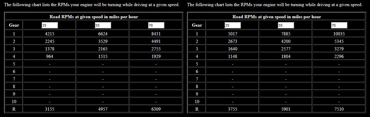

Here's a chart from Grimm Jeeper with the 700R4, NP208 (at 1:1), 35" tires, and on the left is 4.10 gears and on the right is 4.88. Should help you see what to expect, looks like closer to 2300 rpm at 70 mph. If your 4.10 rpms match the chart when it downshifts, I would go ahead and pull the trigger on 4.88s. I would still only expect 10-14 mpg, 10 towing, 14 under the best of conditions. Keep in mind driving these trucks on the highway is like trying to carry a sheet of plywood in a windstorm, definitely hits the mpg hard. Hope for a tailwind.

I have roughly skimmed through this thread and there seams to be some conflict.
I daily drive my 87 V10 short bed. It has 3" of lift on 33" tires, 5.3ls and built 4L60E, 12 bolt out back with 4:10's. At 70mph my truck is at 2k rpm exactly. 700R4 and 4l60E are same od ratio.
Use this calculator, I find it much easier and straight forward to use.
https://www.ringpinion.com/calculators/Calc_RPM.aspx
My truck NEVER hunts for gears, and as long as I keep my rpm 2k or lower, I get 16 miles to the gallon. Now I understand the argument that I've installed a newer more efficient engine/trans combo, but if the OP's engine is making an honest 290hp at the crank, he's within 10hp of my engine. As long as the trans is healthy, he should be able to achieve close to my figures.
If I ran 35" tires I would consider 4.56 gears.
My speedo reads 2-3mph slow at these speeds
