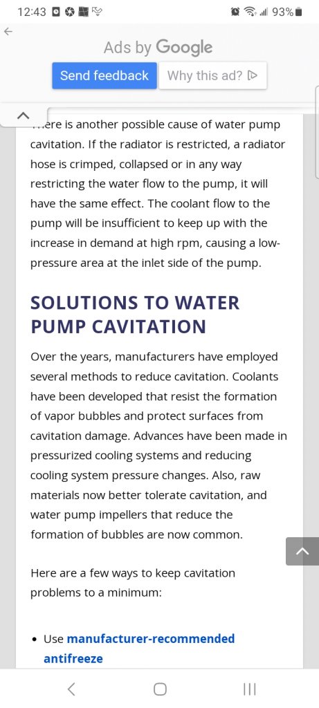

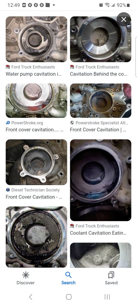

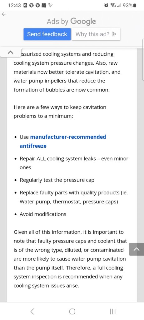

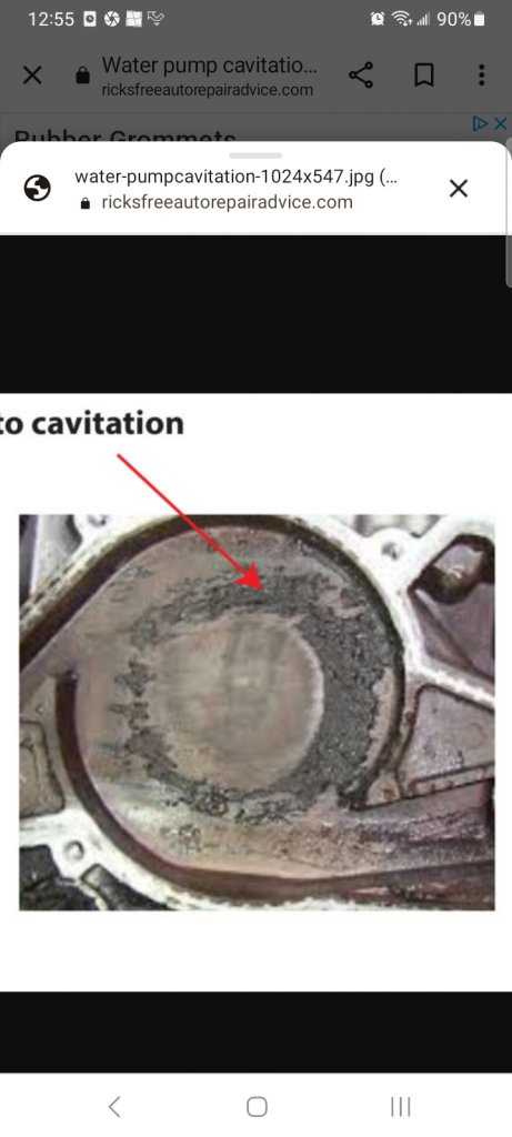

Pump cavitation pics

I said that something earlier. Purchase a quality brand new pump, use coolant mixed properly either premixed or distilled water, and why not check the pH with test strips couldn't hurt. Heck there is a lot of coolant still in the block, maybe it's way out of whack. I think the take away from this imo is to be thorough and it should be fine this time.
One final though from me is if some how there is a small amount of exhaust gas getting into the coolant that would make the coolant pretty corrosive,but generally there are other issues going on with the motor in a situation like that.

I believe Rick hit the answer. The pump is cavitating because a lack of flow. So check the lower hose when running to see if it sucks in. That is why there should be a metal coil spring in the lower hose. Or, the radiator cross tubes are clogged and not enough flow.
The cheap metal rear pump plate, recycled metal probably has hard un-melted pieces that pull out first from the cavitation.
