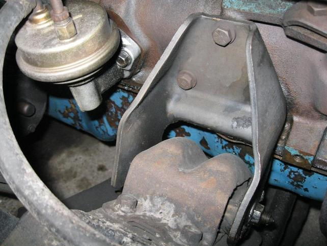

i went from 250 to 350 and the motor mounts had to be set to the secondary set of holes. I have a th350 trans and it bolted right up....dunno if this helps or not. just my experiences
