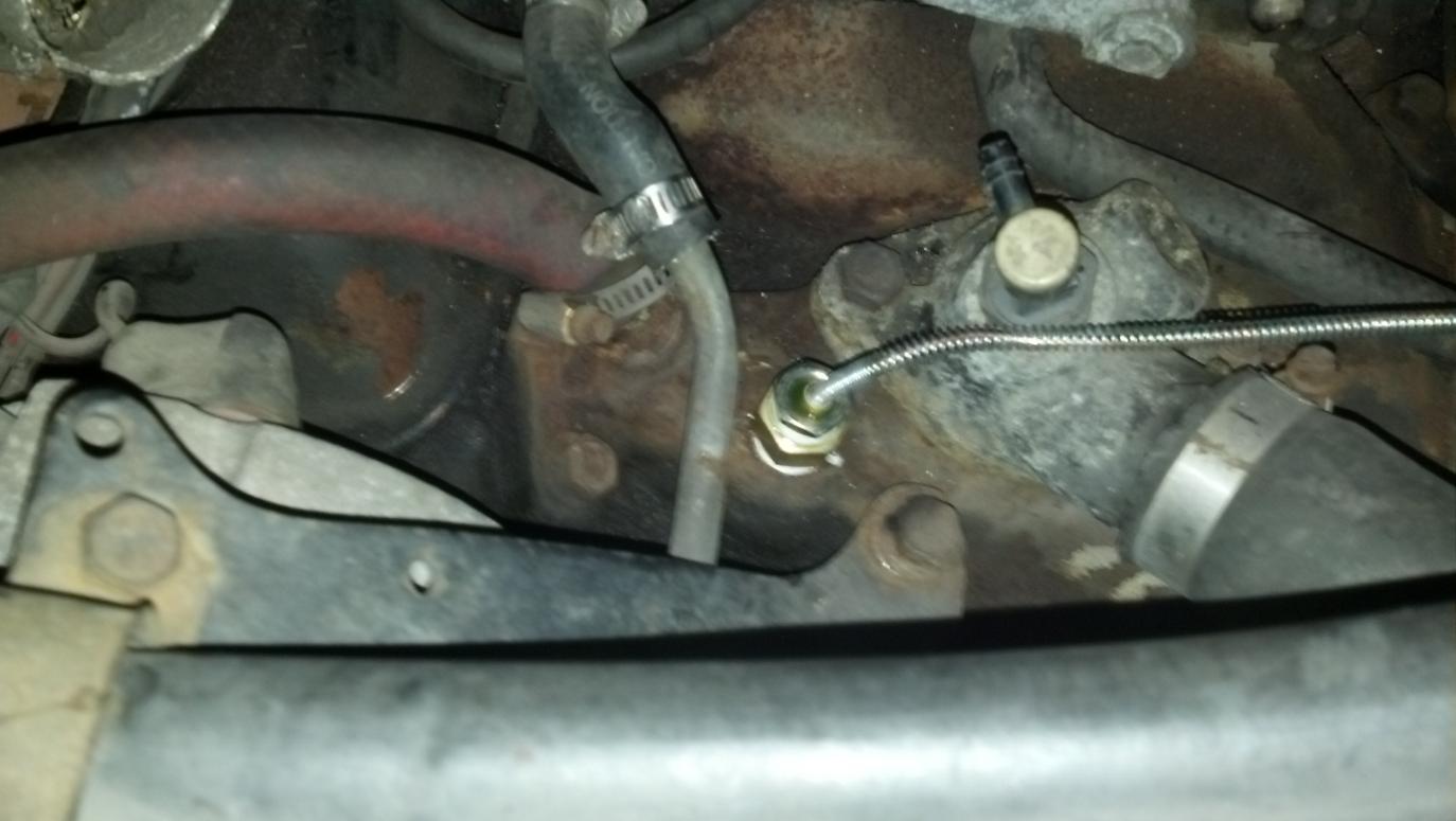

Ok so I'm new here and hope you can help... This is the craziest thing, I wanted to hook up some gauges cause mine aren't working, anyway hooked everything up now the truck won't start at all...
I had to pull the distributor to get the oil pressure sending unit out and the new gauge unit in. I mark the dist as to where I had it when I pulled it. I also found tdc and all that jazz when I put it back in. Checked the cap to make sure it was actually pointing to the number 1 wire and the firing order seems correct.
By the way this is a 84 chevy 350... The only gauge I think I screwed up was the thermostat, I removed some sort of vaccum/sensor that was not hooked up to anything and put the thermo sensor in its place. Could this be keeping the truck from starting?
I have spark and fuel, but will not start at all? Its driving me crazy....:crazy:
Also have another question... What is the big round thing my carb linkage is hooked up to? I had to take all that off as well, but I put it all together the way it came apart. the big round thing has a wiring harness pluged into the back as well.
The truck kinda wants to start if I hold the throttle to the floor, but it just won't do it. I do have spark as well.
