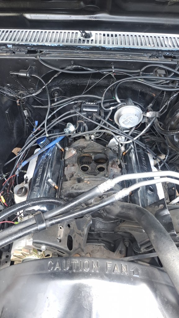

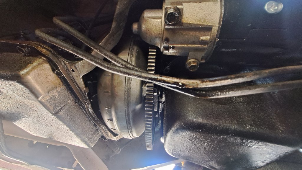

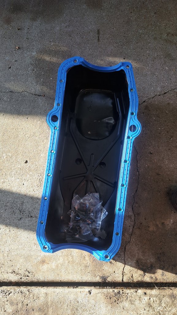

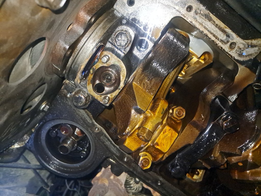

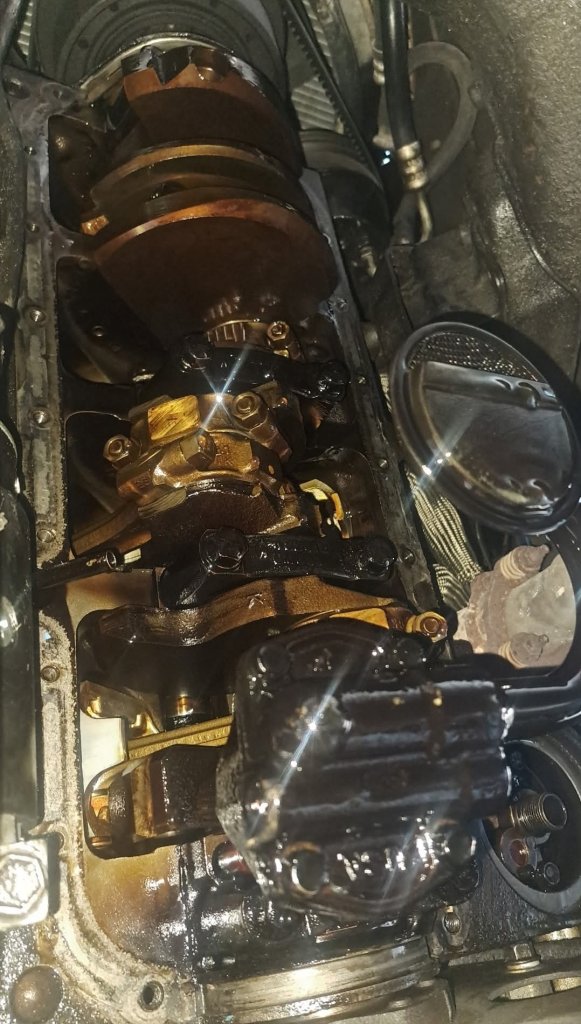

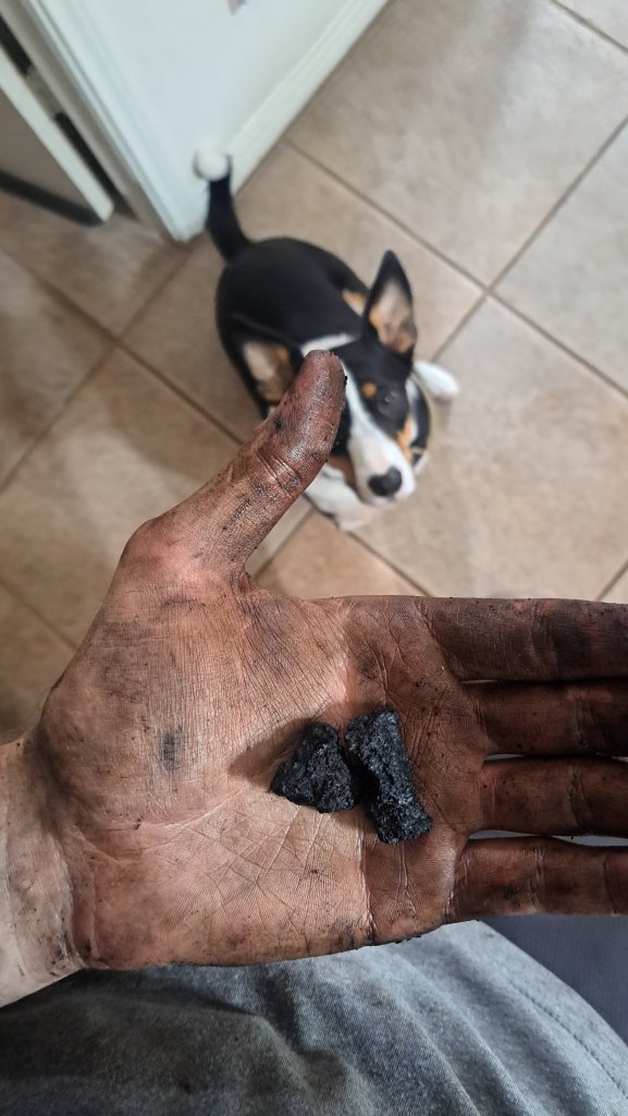

Thanks everyone for your replies & input. I changed the oil again this evening after another 100 miles (changed the rear main seal out as well) and the color is much better, the screen is looking very clear
NICE!

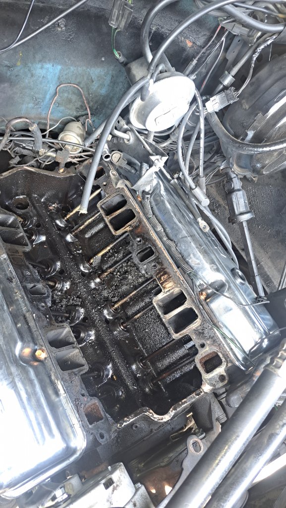

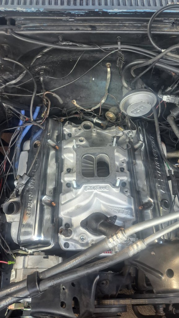

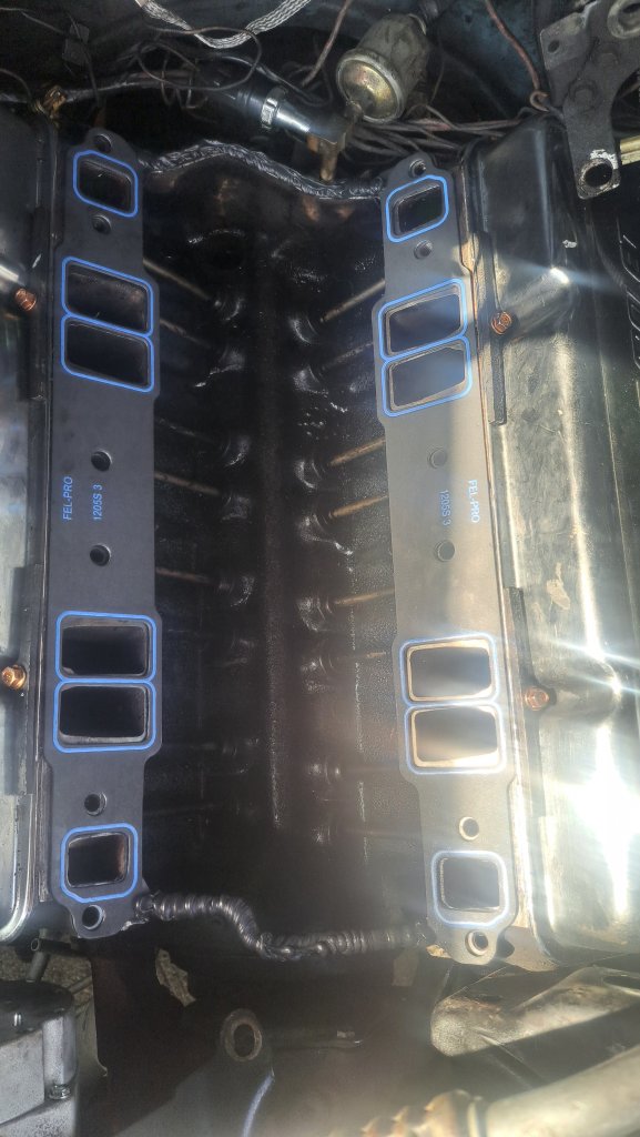

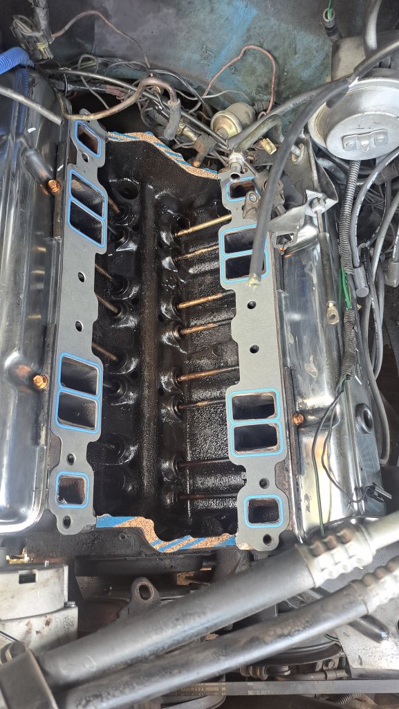

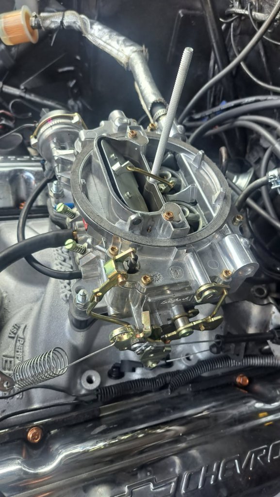

Been cleaning up & solving oil leaks - fixed the rear main, oil pan gasket, oil pressure sensor, and finally got to the intake end rails. Decided to go with the Edelbrock EPS.
I pulled the cast manifold to find nice rock hard substance. Plugged the intake ports, covered the valley & ran the shop vac while I chipped away at it.
Scrapped the cork gaskets in favor of the Right Stuff as usual.

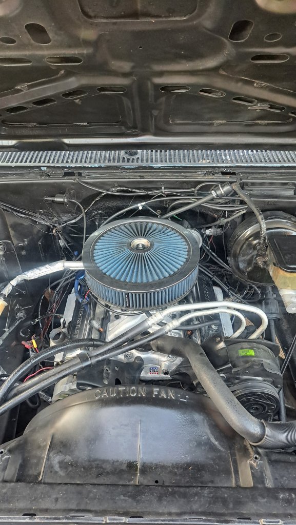

Turned out good, I think. Ended up around 12* of timing (had 14 before with the cast manifold). Doesn't ping or have trouble cranking like it's too advanced.
Blew the idle/gauge fuse at some point so I'm checking wires in those circuits (temp, oil, voltmeter, idle solenoid) to figure that out. I found some wires that were just missing insulation, not pretty.

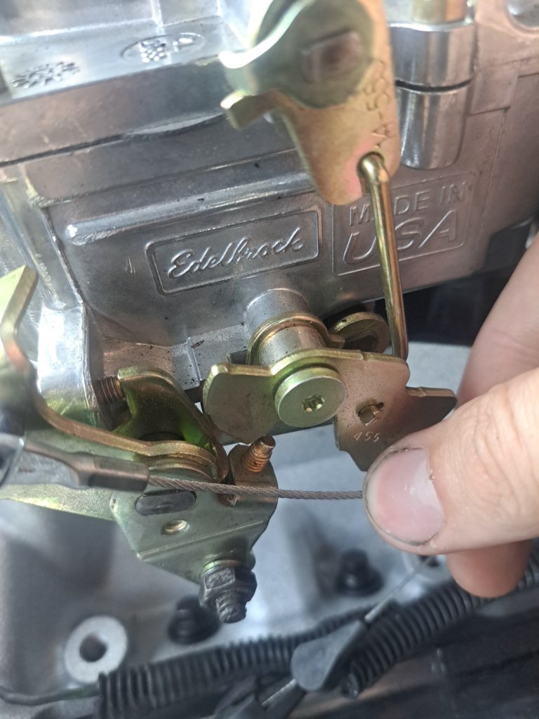

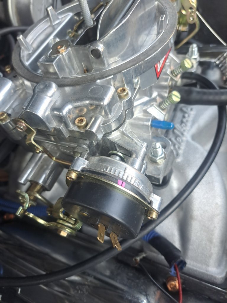

Figured out the blown fuse this evening.

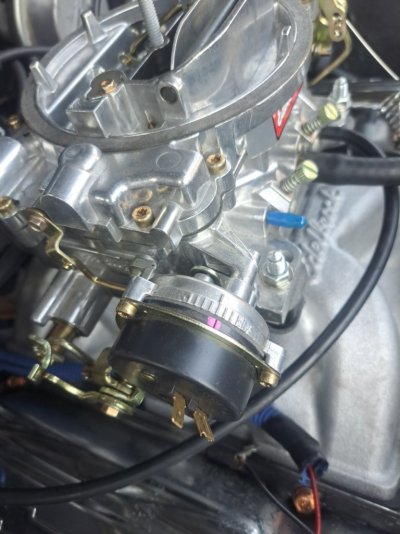

Actually, had two of them, the previously mentioned idle/gauge & the choke was blown.
Dug around following the Haynes diagrams & found the pink & black wire was missing about an inch of insulation & had grounded out to the block. Fixed that.
Then discovered someone had set the fast idle screw to hold the choke open. Not only that, the electric choke cap was not anywhere close.
Fixed that, too.
I also replaced the throttle cable because the old one was very stiff. Fired it up, thing can seriously move now. Didn't expect the cable to be so responsive and I practically floored it leaving the driveway
