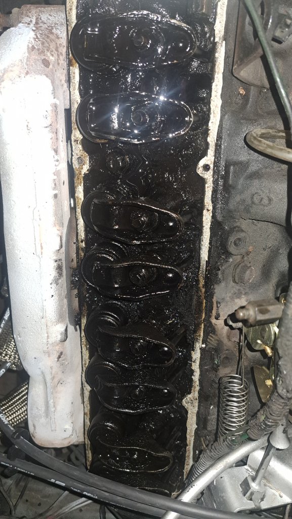

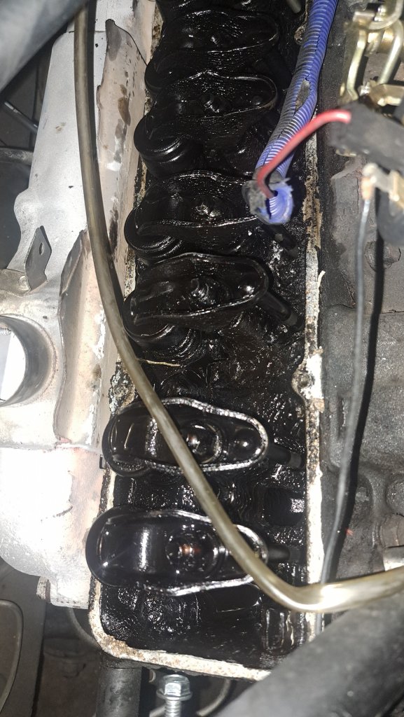

Agreed on all accounts.I agree with most of the advice in here, run a synthetic oil and change the filter religiously for a while. Then pop the VC's off in 6mo-a year and see what it did. Synthetics have alot more detergents in them than dinosaur oil does. I *might* consider even adding like a small pour of ATF at the end of each oil change for the last 50-100mi or so. But I definitely wouldn't do anything to try to majorly break it all up quickly. That'll spell disaster.
