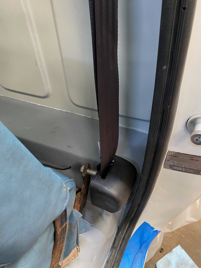

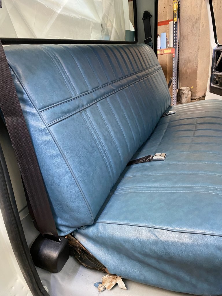

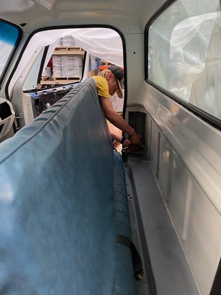

DJ, I did not get ours from LMC finally went with Seatbelt belts plus and had same issue. I just ran a tap a short way and they all worked after that
