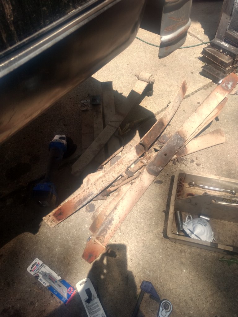

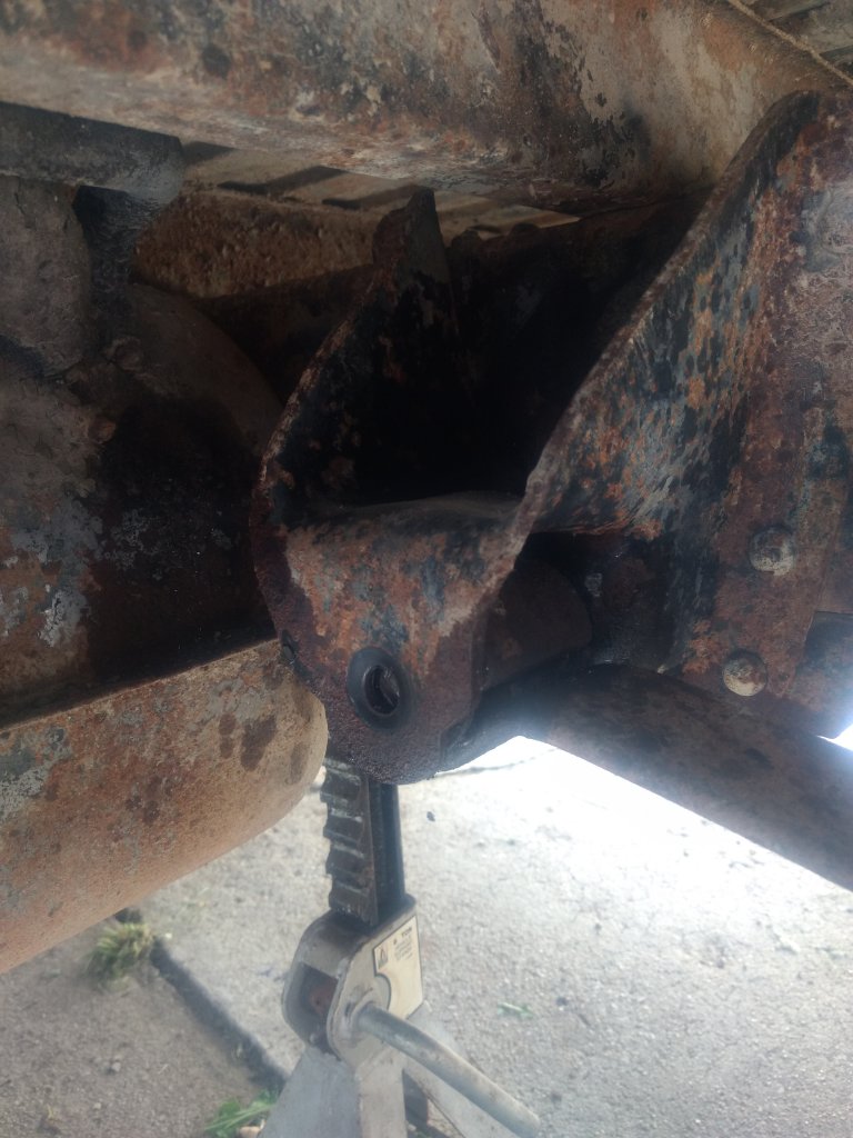

OK, first day of progress: some good, some not so good.
First of all, I only had the front spring bolt and the lower shock bolt give me much hassle. I had the frame supported under one jack stand (forward of the rear axle) and after removing the tire I put one under the rear axle as close to the back of the backing plate as I could. Finally, started cutting everything out -- the only thing I needed to save was the bracket that sits over the springs and the U-bolts go through.
I was surprised to find that the U-bolts had so much tension on them, but nothing came out of place during the disassembly. To really get good access to the front bolt I eventually "disassembled" the stack (I found it already had _two_ leafs broken, and I swear one half of one leaf was missing (see picture of the aftermath). I also cut what was left of the broken top leaf at the bushing. This gave me as much access as possible, I definitely need to look at better reciprocating saw blades! The lower shock bolt was easier with the new cordless grinder with a thin cutting disc on it.
With everything out of the way, I started to put the spring and shackle in place -- this is where everything fell apart. I put the bolt in the front mount (with plenty of anti-seize) and in the shackle to the rear mount (same), now I can't get the rear spring mount to line up with the shackle, and the locating pin on the rear axle doesn't line up with the spring. I checked the dimensions, and they are correct per the website, but still no joy. They seem shorter than the other side (only took one side apart at a time) but both original springs are totally trashed. It's about 3/4" off on the center pin, and it's correctly positioned front-to-back (back being longer dimension).
Did I miss something? Should there be some tension with new springs? Right now I'm at a loss as to what's needed next.
