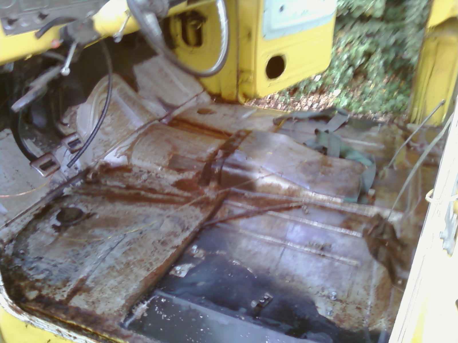

Hot Rod, I thought the center hump in those were removable. I know they are in the older trucks. In the Shop Manual they show installing/removing the transmission from the opening in the floor. The 2WD trucks or those without the HD transmission do not have removable humps, but the 4WD and those with HD transmissions have the removable hump. You need the flange for the front part of the hump and that is not removable, but the hump bolts to the flange and the floor. Is it different in the squares?
Edit: This is the cab of my '65. This truck came with 3 on the tree and has the low hump. I have the flange and the high hump to switch it over to the HD 4 Speed. You can see how the low hump cabs are set up to accept the high hump flange and the hump itself. Just have to cut enough floor out for the hump to sit on and bolt it up.

Yep, but the 81 up squares don't have bolt on humps, with exception of the 1 tons with SM465 or 4x4 I do beleive, unless the pic I seen was the older 80 on down. Even the 80 on downs were not all bolt on humps. I also the flange is different from 73-80 truck to 81 up trucks otherwise, I'd just snag a bolt on hump from an 80 on down and them cut and drill holes on mine. Worse case scentario, I'll just have to cut out the hump from the fo buh fo cab. And when I do, I"ll be cutting some extra, and hope to make it a bolt on or screw on hump. And then who knows, I don't like body lifts, but I might just do a 2 inch body lift, maybe it has to be 3, not positive just yet on that, but avoid having to cut the hump by doing a body lift. Also, if I found a 1 ton frame, and used a 1/2-3/4 ton frame crossmember I tihnk I'd be OK too, cuz the 1 ton frame if I recall, is taller, so the that extra distance might allow me to use a 2wd drive cab too. We'll just see when I get that far.
