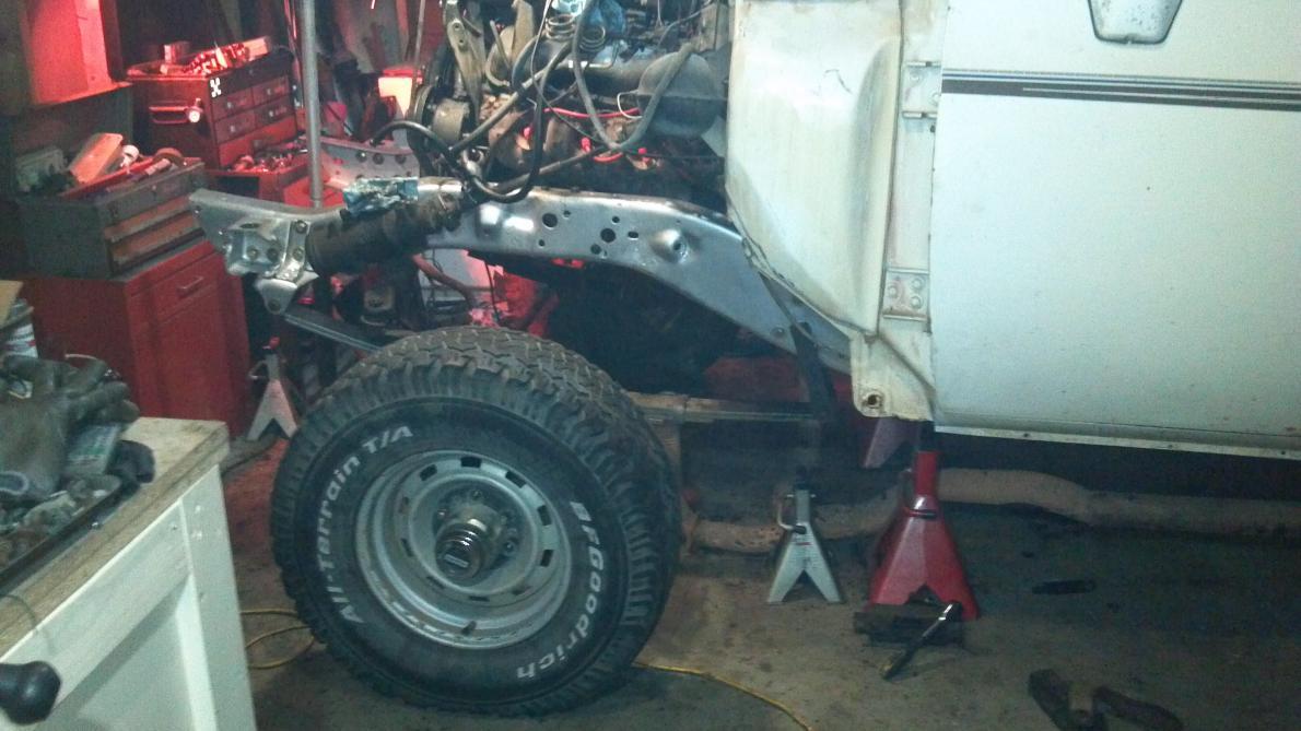

I am finishing this very same coversion right now. after i finish the rear i will be posting up some pics and later a write up of how i did it.

yep i have a 88 2wd crew cab 1 ton srw. that is now 75% done with a 4wd conversion. its getting a 6 inch lift 37" military goodyears and humvee bead locks. the pic i posted is the front frame after i put the weight of the truck on it with stock 31" tires.
tonight i am converting my fornt d44 to 8 lug.
