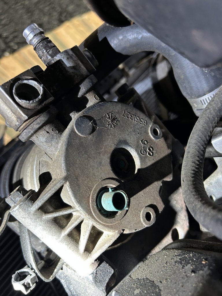

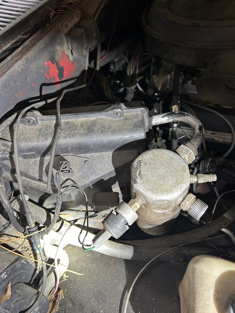

ok thank you. i have to work 16 hrs till Wednesday and then i am going to get back on it. i believe i follow what your saying. thanks so much for the help. is the high pressure switch on the ht6 compressor on the back?
Yes. That's the high pressure switch. The original low pressure switch is on the manifold right above it that has the hoses cut off in your picture. The squarebody has the low pressure switch on the filter dryer instead, and doesn't use a relay. So the entire compressor engagement amperage is being driven through that switch. The components will last a lot longer if the switches are only turning on/off the low amperage command signal, which is then commanding a relay to engage the compressor clutch.
ok i am getting there i believe i am fully understanding everything. you have been a big help i hope install this weekend. i still am not sure where the low and high pressure switch wire into? a relay? then out of relay to compressor clutch?
i thought the low pressure switch was on the dryer?

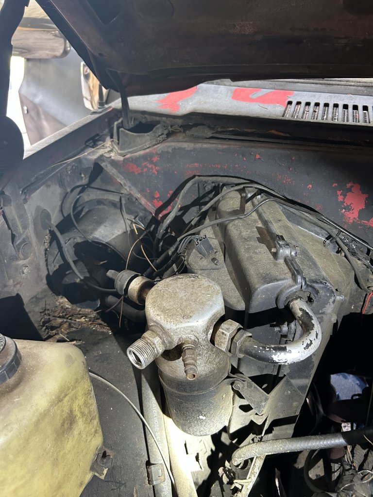

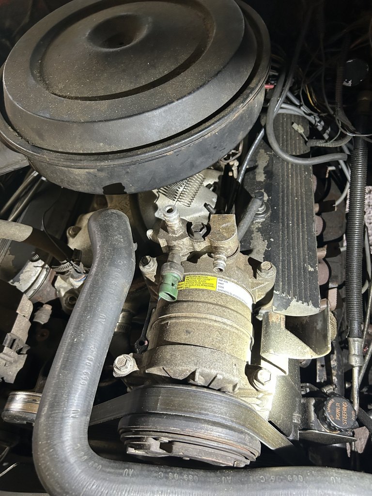

ok so... LOL heres where i am. i got new compressor, hoses, dryer and head unit.
i got the fan to blow on all speeds. i jumped the low pressure switch out and it sent voltage to the pig tail for compressor. im assuming thats how it works. the new 1996 dryer will not mate with the 1987 evap. different threads. so thats where i am stuck at.... get a 1987 dryer and have a custom hose made from 1996 compressor to fit the 1987 dryer? or any ideas?
