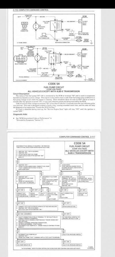

When I follow the troubleshooting instructions found on this site for the fuel system, It says I should get an error code of 54 for a "failure in the fuel pump circuit". I didn't get that code. It also says there that there is a terminal for testing whether the fuel pump functions. I have a red pigtail hanging off of the harness, and other sources have spoken of a red pigtail existing for testing purposes. When I jump from the battery to that red pigtail, I do not get any voltage at the connector leading to the fuel pump. Can anyone confirm my understanding on this?
PS: I am back in the situation where after turning on the ignition to "run" (not start), there is about a 2 second delay and then I hear a "click" from the fuel pump relay. My understanding is that the fuel pump should be energized for about 2 seconds after turning on the ignition (until the engine starts). Does any of this make sense to anyone? Why would there be that delay before I get the "click"?
If you apply 12v to the red test lead, you should have 12v at the connector to the pump. The test lead splices in downstream of the relay per the wiring diagram. you can also apply 12v straight to ckt 120 on the harness with the relay disconnected and get 12v at the connector at the pump.
you should be able to put 12v on the pump test lead and put one end of your meter at the relay connector on the ckt 120 wire going to the fuel pump and the other lead of your meter to ground and see 12v at the meter, right? But that won't tell you if you have an open from the relay to the pump...only that the test lead is connected to the circuit.

The red test lead actually just goes right into the relay connector and should supply whatever voltage you provide. As I recall from my previous attempts last fall, that connection makes a bridge to another contact point in the relay, which should, in turn, run the pump. I now remember jumping across inside the connector, with it unplugged, from a good 12v source inside the connector. That should accomplish the same thing. I still get no voltage at the connector near the tank from doing that, or using the red pigtail with the connector plugged in.
The only other connector I could find in between relay and tank is one which plugs into a unit which I believe switches between the two tanks. It is a large-ish metal block with fuel lines routed to it, I think. It's dark now and I can't look again to confirm. I did pull that connector out of the block and all contacts look clean and good. It seems hopeless to trace the entire path of wiring from the relay to the pump. Too many junctions and hidden/confused passages.
Tomorrow I can check if voltage is making it to that intermediate connector spot. Not sure what else to do. Still don't understand why the "crank fuse" originally blew when it quit running, but replacing that fuse did not fix the problem. Thanks for the input.

this is from the 1990 manual. but I'd suspect your 87 is a similar setup except you might have the complexity of 2 tanks.
