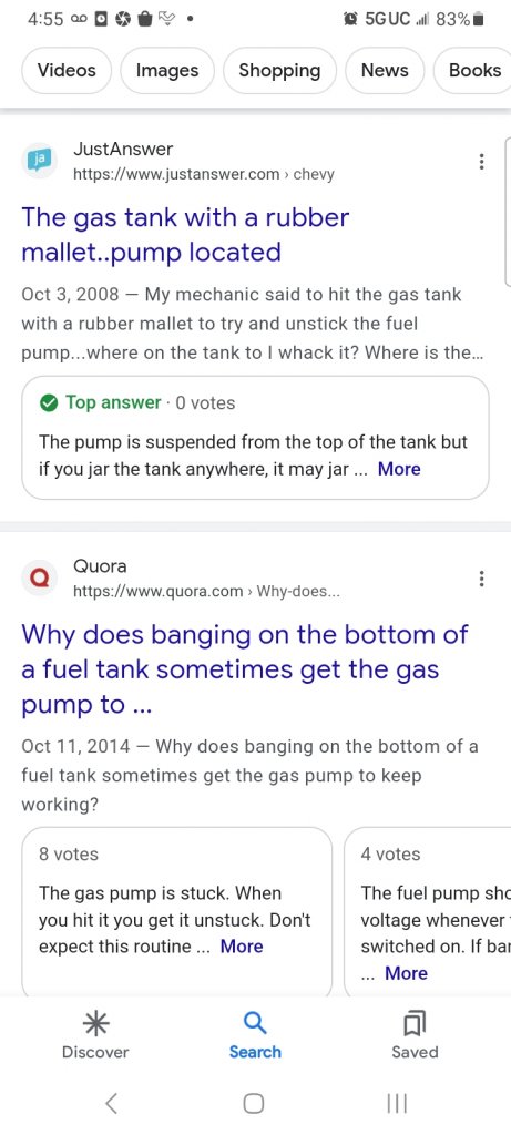

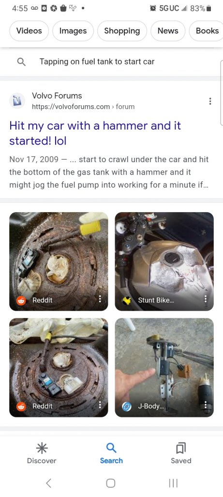

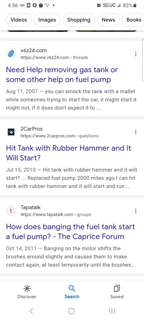

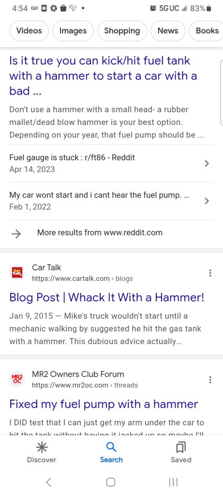

@KnuckleBuster I don't have a problem whacking a gas tank with a rubber mallet. And I certainly don't care if you do it...
Just to be clear, I NEVER said to whack the tank with a rubber mallet. Hand slap only. It doesn't take much.
10,175
19,676
Lots and lots and lots of people smack em with a board a mallet, a hammer. And I don't care! I merely said I was told to quit doing it and why. And from now on if you'll just drop it I'll tell everyone the first thing to do if there car won't start is slap the gas tank with their hand.
