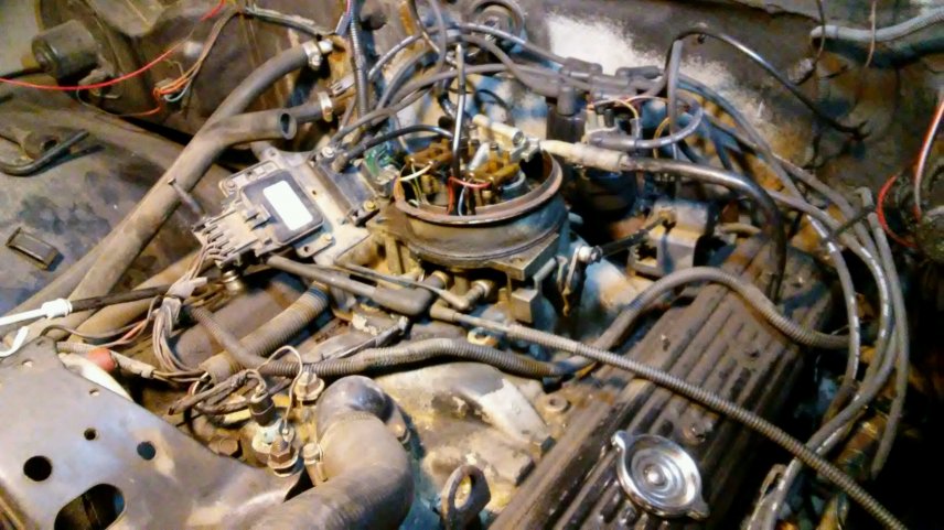

It would be really nice to have an ungraded engine with more HP/torq than the standard replacement but with planning to go back with tbi and the fact that this will just be an occasional use work truck for pulling an 7000 lb tractor on a 90 mile trip a half dozen times a year, not sure I need it.
So anyone bought the TBI crate engine off of JEGS?
Also, I read some comments on JEGS about pistons being used that were .020. I was assuming the blocks were probably rebuilt with liners and were standard bore. Anyone know for sure?

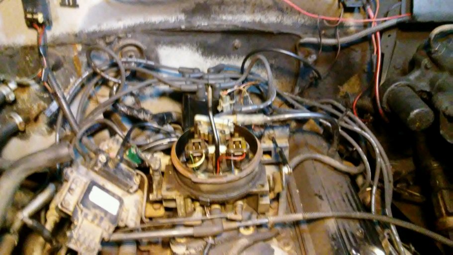

After some family inlaw health crisis, getting back to the C30 engine hunt.
I am wondering if going with a BluePrint engine would be worth the additional cost. I'm thinking this would be the replacement for my TBI truck with just being able to swap over components and go.
Would the increased HP that is advertised be true if using my TBI?
Also says its not for use in pollution controlled vehicles. Aren't all TBI vehicles considered pollution or emission controlled?
