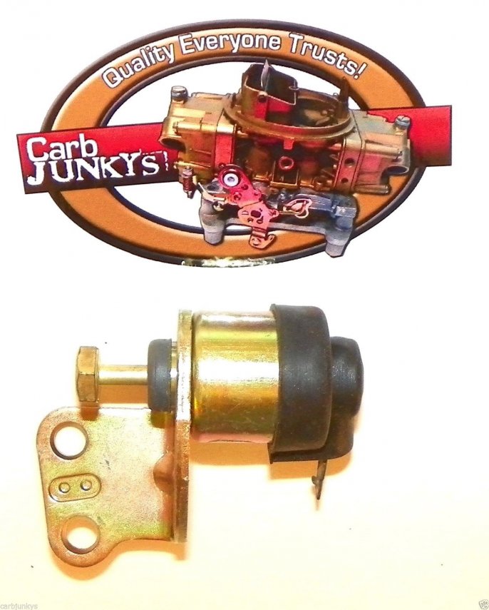

Well, I have the same year carb, but it's the computerized E4ME not like the truck one (not computerized). I know mine has a dashpot or idle stop solenoid which, to the best of my knowledge, is supposed to help with run on, and it's supposed to kick the idle up a little when you cut the air on. I haven't seen an '86 truck with a Quadrajet in like ten years so I don't remember if it had one or not. It looks like this and bolts into the carb body right in front of the throttle arm. Maybe see if it's missing?

Awesome, thanks man! I'll look today to see if it's there, it seems to run perfect since having it rebuilt the right way, it just has that off idle stumble when the ac is on. It's been brutally hot here lately, 100+ for the past week, so I'm not going to run the truck without the ac on! lol
