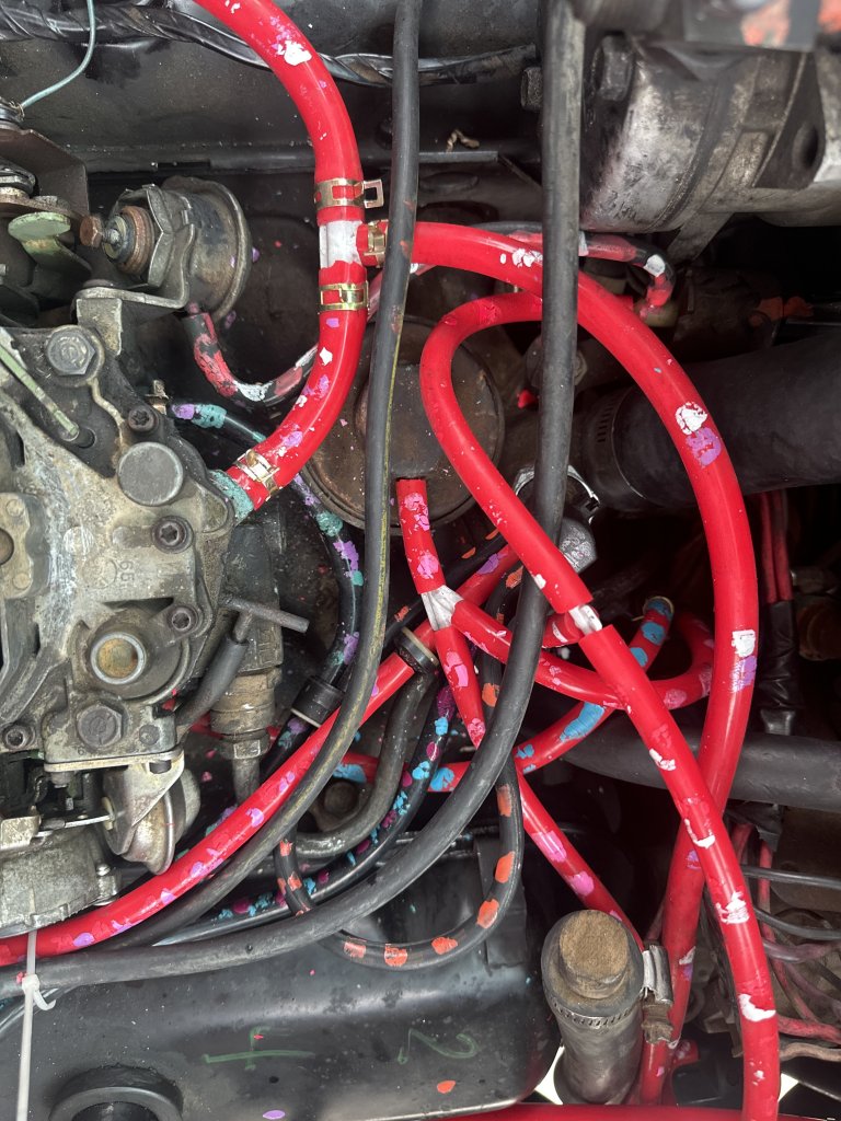

The something is not hooked up right. I am broke down at the gas station

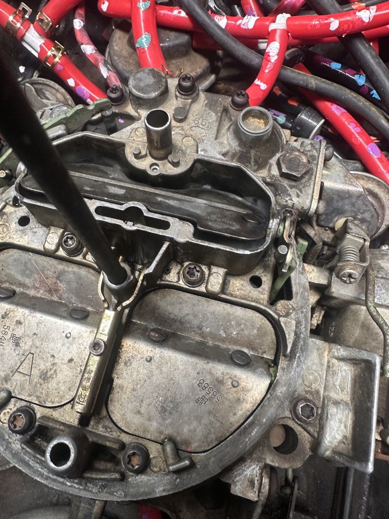

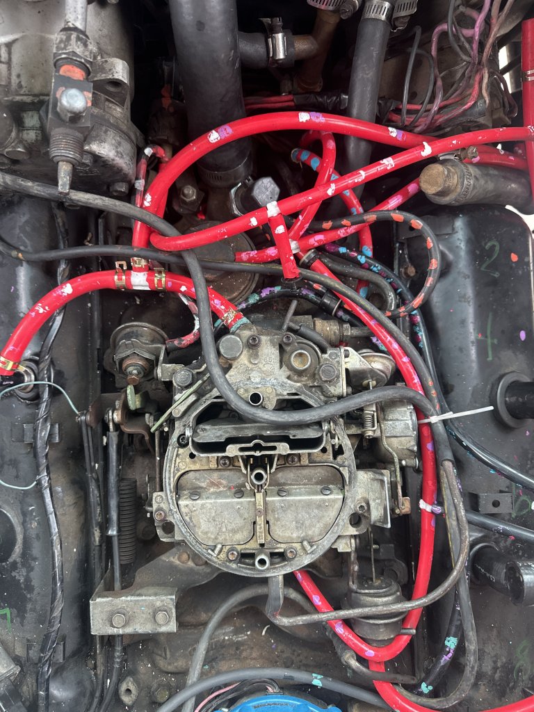

I’m not a scammer, I was able to extend my stay. Replaced the starter, starter power wire, both intake valve valve covers ignition control module, got it started yesterday but smoking white out of the carb and from back. Coolant level is fine, I changed the oil, not the filter because I couldn’t get it off. Now I’m at the gas station because I’m pretty sure there is a hose not be rotted right. And I’ve been doing this all by myself. I’m stuck in a town that I know no body and I’m a vet with 2 dogs, I had to rent a hotel room last night. Please help
For sure not hooked up correctly. I see two ports without vacuum lines going to them. I don't know for sure where they are supposed to be hooked up to, but those are creating a massive vacuum leak and the engine will never run right like that.

No, they were hooked up the top to the canister and the small one gets capped off.
