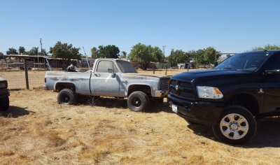

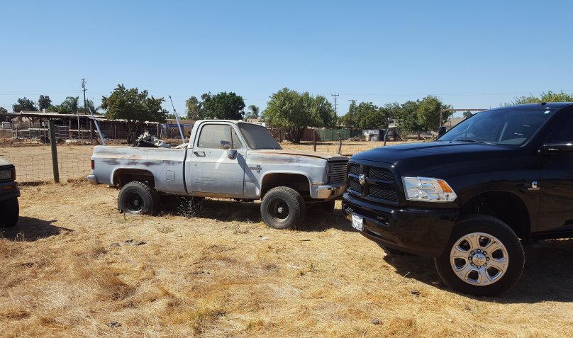

New to the forum and want to share my current project. It's a 1983 K10 6.2l deisel 4x4 swb single cab. Purchased truck for $800 runs and drives equipped with 350/th350 np208. All coming out besides to t-case.

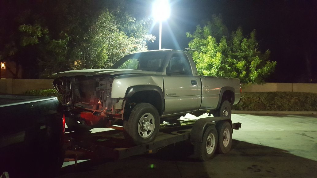

Also got my hands on a wrecked 2003 silverado with the lq4 6.0l. 4l80e 2wd. for 1500 bucks.
I plan on using as much as humanly possible off the donor truck for the swap as possible.
Please feel free to advise, criticize, and comment on this build as you please.
