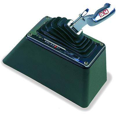

ordered the shift

ordered the shift
That's the one to have. Either the MegaShifter or the QuickSilver. Reason being, those 2 shifters are compatible with both 3 and 4 speed autos, so if you swap trasmisisons then your shift is going to work. Some models are 3 or 4 speed only. Both are also ratchet shifters and NHRA approved for racing. Both will also run a reverse valve body if you so choose and go fast enough that some NHRA events might require it.
