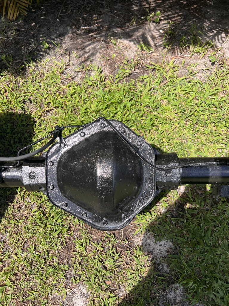

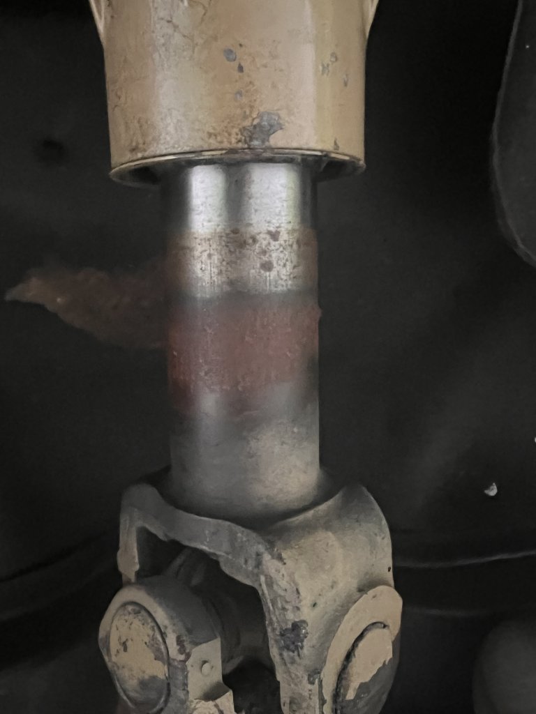

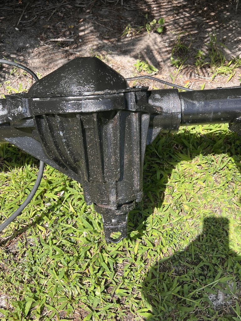

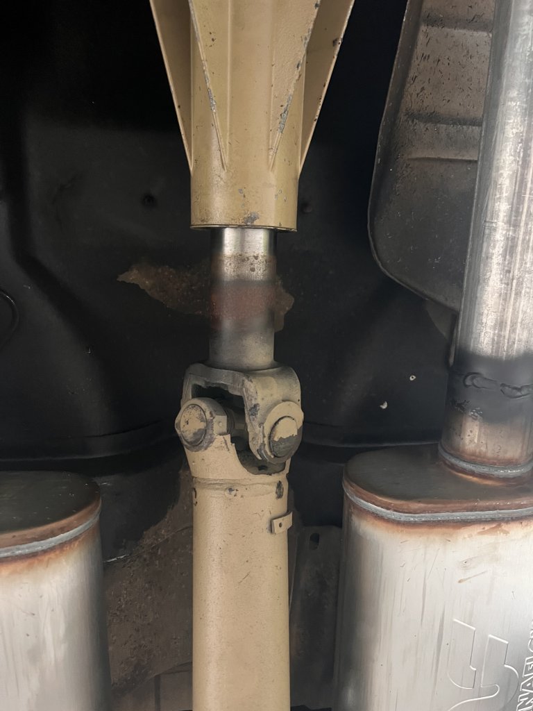

I’m swapping a 14bolt FF into a k5
Truck has a 4”lift and currently the slip yoke sits out pretty far. Drive shaft looks like it is 2-3 inches too short.
My question is the new diff is bigger. Does that mean the yoke on the diff is maybe 2 or three inches longer and then like magic my drive shaft will be just the right size now?
I’ll need a special joint that would connect to he 1/2 tan shaft to the 3/4 ton axle that I’m assuming someone makes

Yes, the 14BFF yoke is(I think) about 2-3" longer than a 10 bolt one. You will want to check driveline angles also before you bolt everything together.

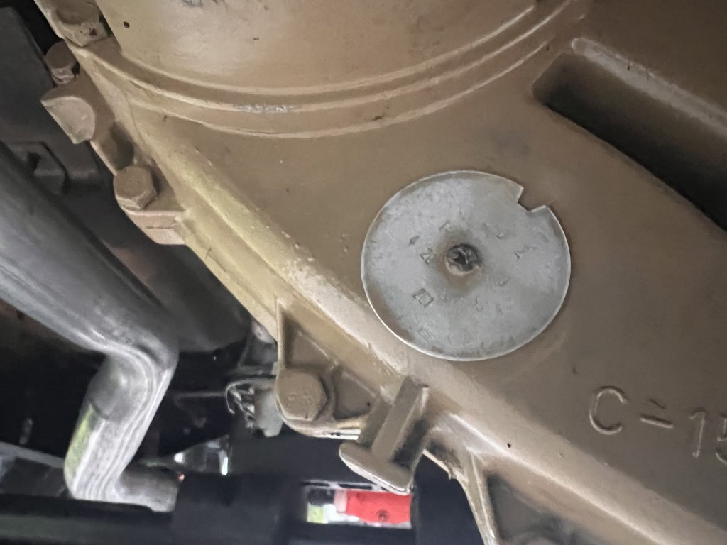

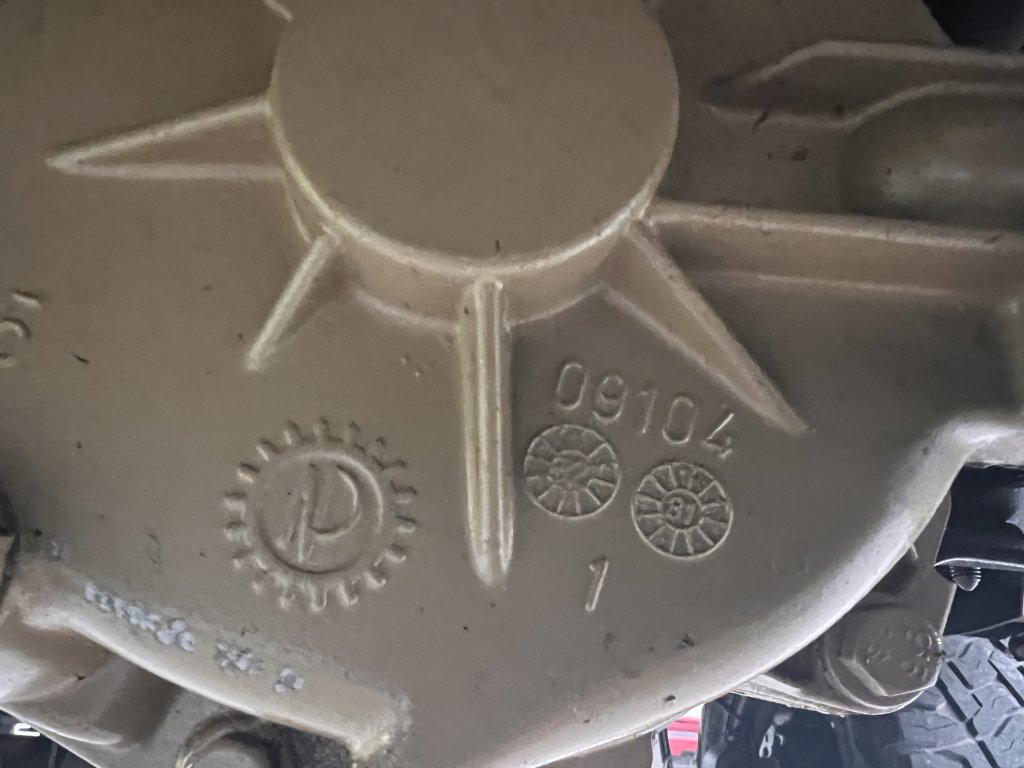

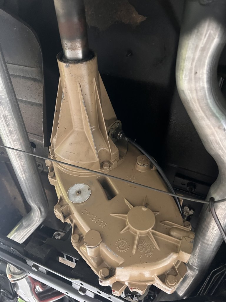

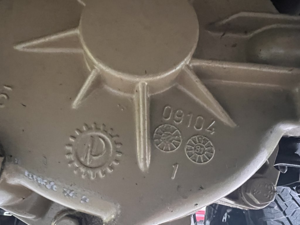

I may have seen the wrong numbers
Is this the tag I should be looking at?
The front shaft is on the correct (passenger) side
Here are a couple pictures of the case

The 208 was used from '81 to '88. Then the 241 was used after that. No 261 in these trucks.
Yes, the 14 bolt diff is bigger, but the yoke is rather close to the center section for it's size. Your driveshaft will fit roughly the same after the swap.
The conversion u-jount you need is Precision #447. Unless parts have been swapped around in the past, of course.

That there is a 208.
I wouldn’t buy any u joints on assumptions. Get a set of calipers and measure what you have and buy accordingly.
