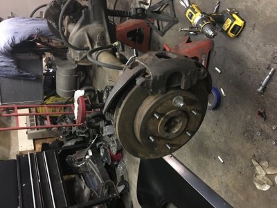

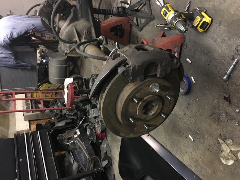

My front got the deluxe treatmend and the rear is well on its way

All depends on what carrier I find as to which axles I use. I'm going to put counter sunk bolts threw the rotors and put in longer studs. It's gonna have 36/12.50s mounted to it. I'm not a crawler I have no patience for that I'm happy ina mud hole.

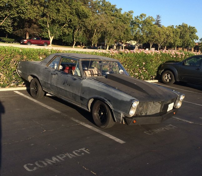

No we went sbc - Pontiac anything is too expensive!! Maybe one day but for now it's a mutt.

Yep, I get it. Not to mention the selection of options to choose from in power parts. I had to sell all my BB Olds 455 and 425 dreams. I wanted to put either my Olds 425 or one of my 455's in a square. And twist the fukn' frame up like a donut twist. Never happened. Sold Out all my Olds parts. Just can't beat Chevy selection and prices compared to the big brothers and sisters.

Damn that would've been pretty awesome. It's a bummer they're so rare and coveted..
I'm well beyond a restoration worthy base, so I don't mind pissing off purists. It's not a gto so it would need to be absolutely mint for it to be worth anything. If the homemade cowl hood and front end didn't piss them off enough, then the Chevy heart surely will :)
