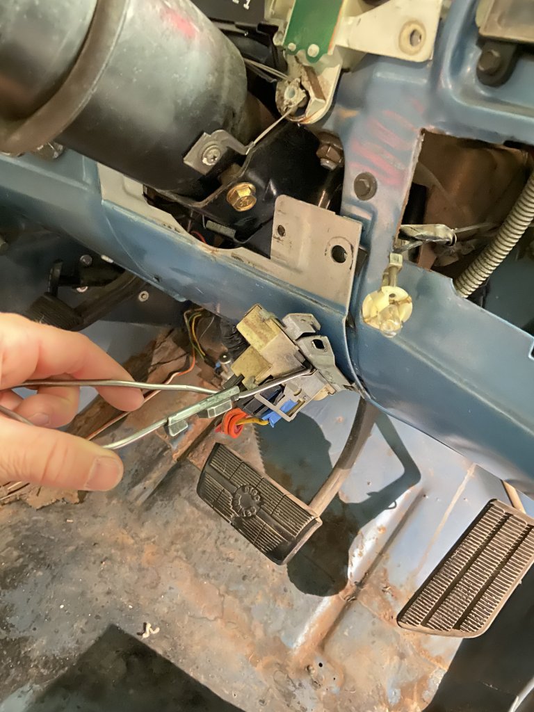

flashers are good. some funky wiring going on, the previous owner rigged the ignition where the key is only to unlock the steering wheel. ignition switch is mounted to column. also wired a kill switch. guess will have to let the pros take a look at what's going on.

That looks horrible, I think a dash harness is available. If not how about a salvage yard? Probably would be better off pulling it all out and starting over rather than chasing various electrical issues.

yeah I don't know what the idea was with that. The wiring actually doesn't look to bad might be fairly new. yeah what a pain trying to chase down wiring!

The previous owner may have added that rat nest to bypass an existing problem. You won’t like it, but probably need to start by getting the whole steering column down to bare bones. The ignition switch might be the first thing to look at as it’s the hardest thing to get to and the most likely culprit he was trying to bypass. If you have the dash out, you may be able to reach it from the top. From the bottom, you are going to have to unbolt the column from the firewall to drop it down a few inches to get it off the top of the column. And while you are there, replace every single switch you can from the high beams, turn signal, wiper, ignition, revers/neutral safety even the horn. You will never want to do that job twice.
