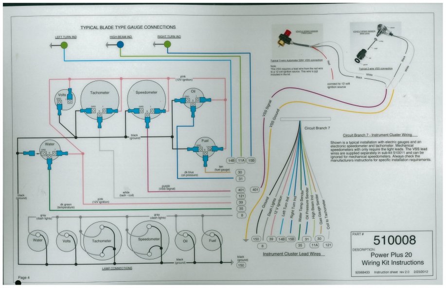

Hello. I bought a wiring harness, i cant remember which company i bought it from. I believe it is the one advertised as "a wiring harness specifically designed for your classic truck" It ended up being from "American Auto Wire" Its mostly straight forward but I have run into a few problems.
1. there is three black wires come from the cluster connector. Do they all get connected to the same black wire one the new harness.
2. there is two Pink wires with black stripes. What are they for?
3. I have a manual transmission. I don't think i need a neutral safety switch, what gets connected to the''S" terminal in the starter solenoid? (page 5) on the wiring diagram)
4. there doesn't seem to be provisions for a wiper switch?
Thanks in advance for any help. Hopefully ill be able to attach the instructions.

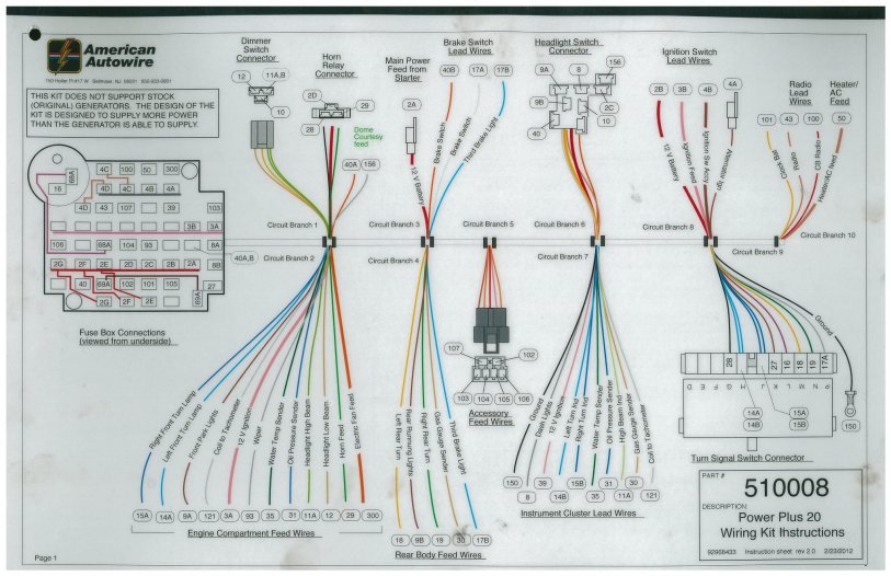

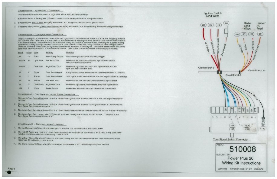

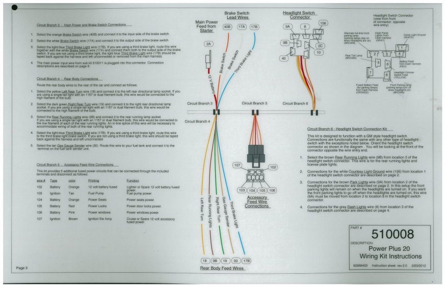

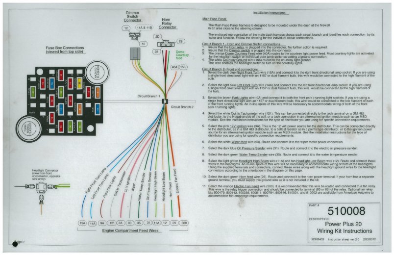

heres some of the instructions

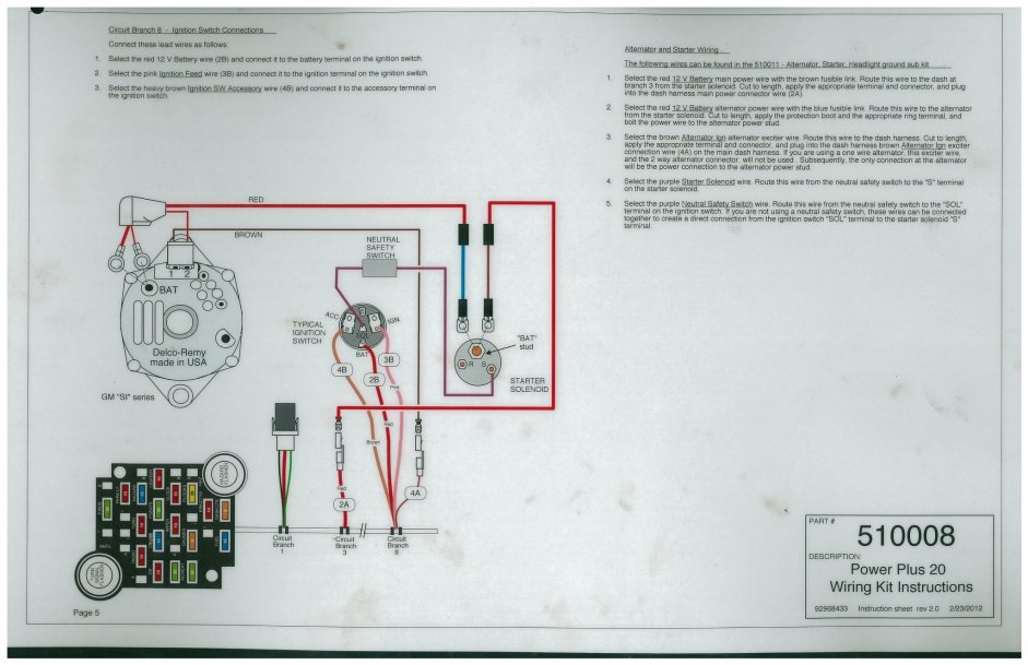

and he last two

1. there is three black wires come from the cluster connector. Do they all get connected to the same black wire one the new harness. Yes
2. there is two Pink wires with black stripes. What are they for? They are the hot wires for the various gauges and warning lights. The hot leads for dash illumination are the grays.
There should be a clutch safety switch that is actuated (closed) by the arm when the clutch pedal is depressed. It is just like a brake light switch but on the clutch arm. Wire the purple lead through that switch. Or, if you wanna be a gangsta, just go straight from the ignition switch to the solenoid "S".
There doesn't seem to be any - because there isn't any. They only provide a hot wire out to the wiper motor. You have to make your own harness for bringing the circuits back to the switch (3 circuits minimum - low speed, high speed and washer pump).

Great thanks. i got the truck running today. I haven't done gauges lights or wipers yet.
Im gangsta so i ended up wiring straight from the yellow wire on the old ignition connecter to the purple wire that goes to Sol on the starter. Hopefully ill get everything else done on Saturday.

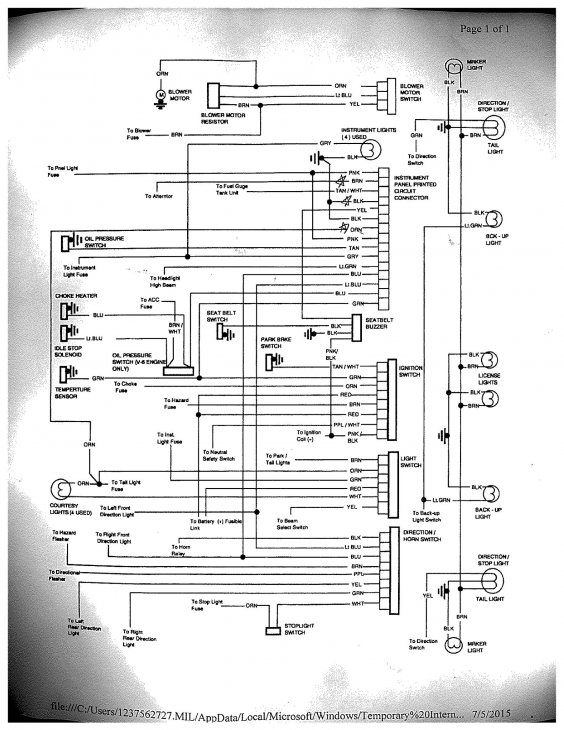

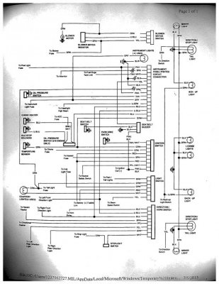

Does anyone have detailed diagrams for the wiper circuits? I have a 1985 with delay, low, high, mist. I'm doing a conversion and need to know what goes where exactly. I'm using a 1994 k1500 harness for my conversion and I'm having a hell of a time converting the square plug from 94 to the 2 plugs on my 85 wiper motor. colors aren't the same :p
