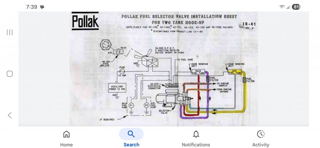

Does anyone have the wiring Diagram for the 6 port selector valve?
As in what wire going to the valve does what?

Try this

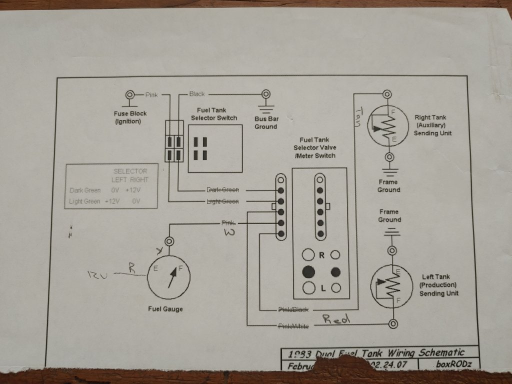

Here is the one I used on my K20.
