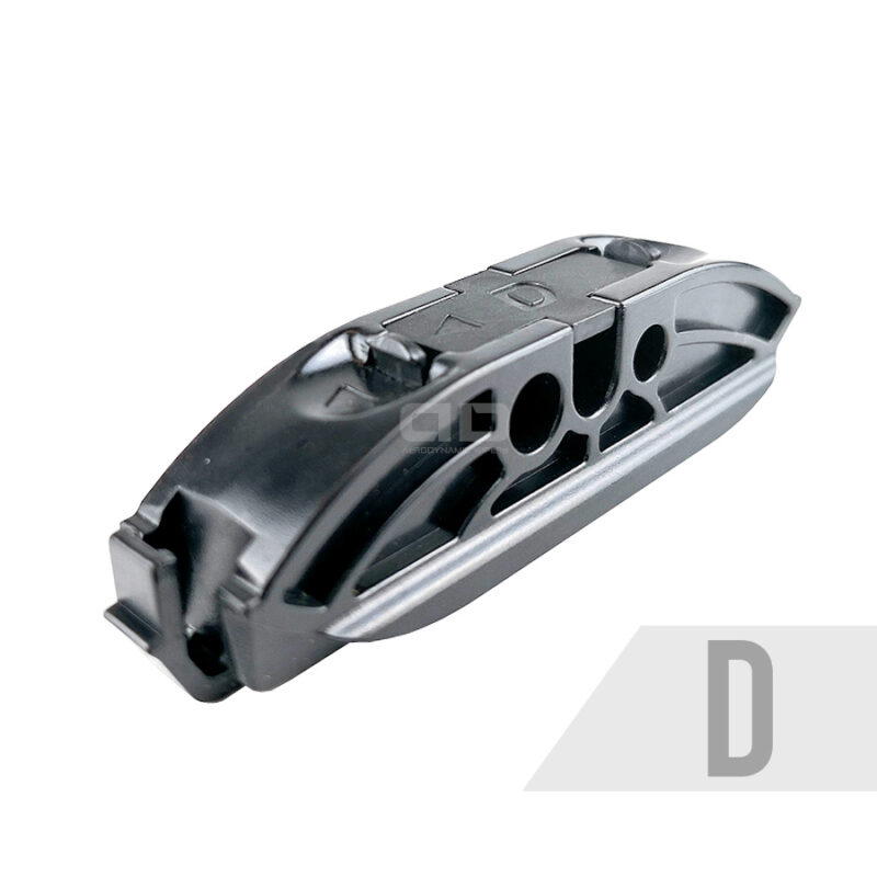

I just purchased through an online store - adwipers.com.au. Blades through this lot are all branded as their own - Adwipers
15" frameless blade
And ordered adaptors to suit the side pin wiper arm as that one is not included with the blades
I ordered through these guys as it was the first place I found that had adaptors to suit the side pin style on my arms - all the local parts stores just had the same generic stuff to only suit common vehicles on the road
