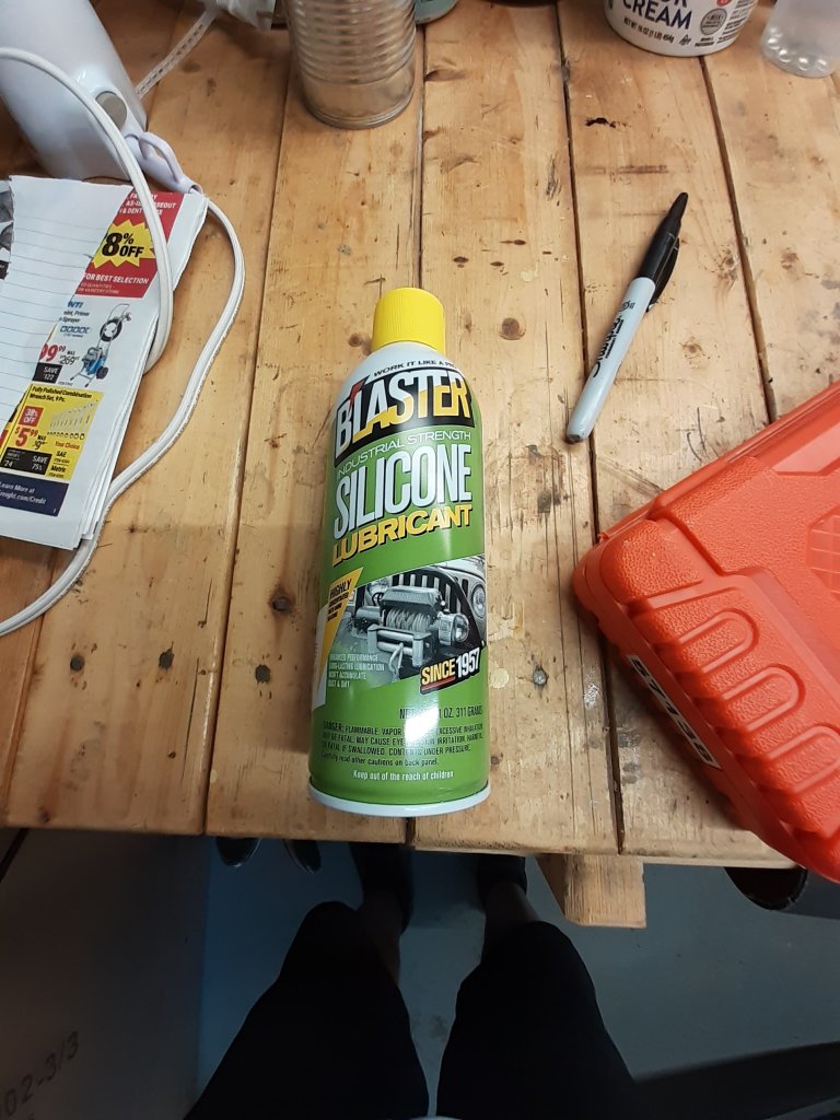

Try silicone spray. One of the guys suggested it to me on my new seals and it helped alot.
