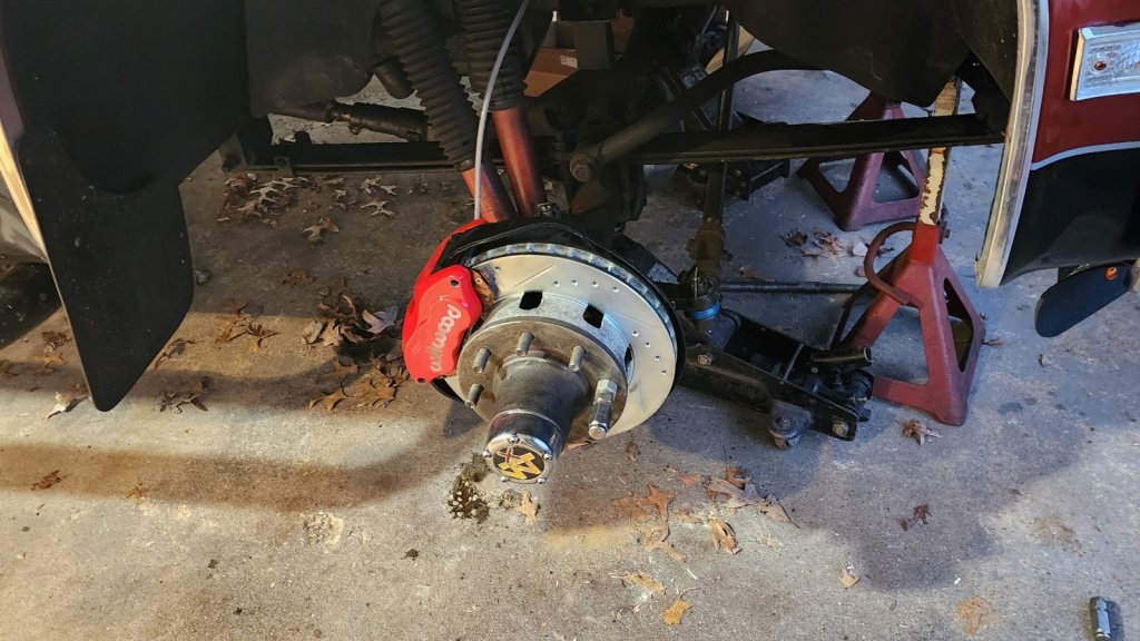

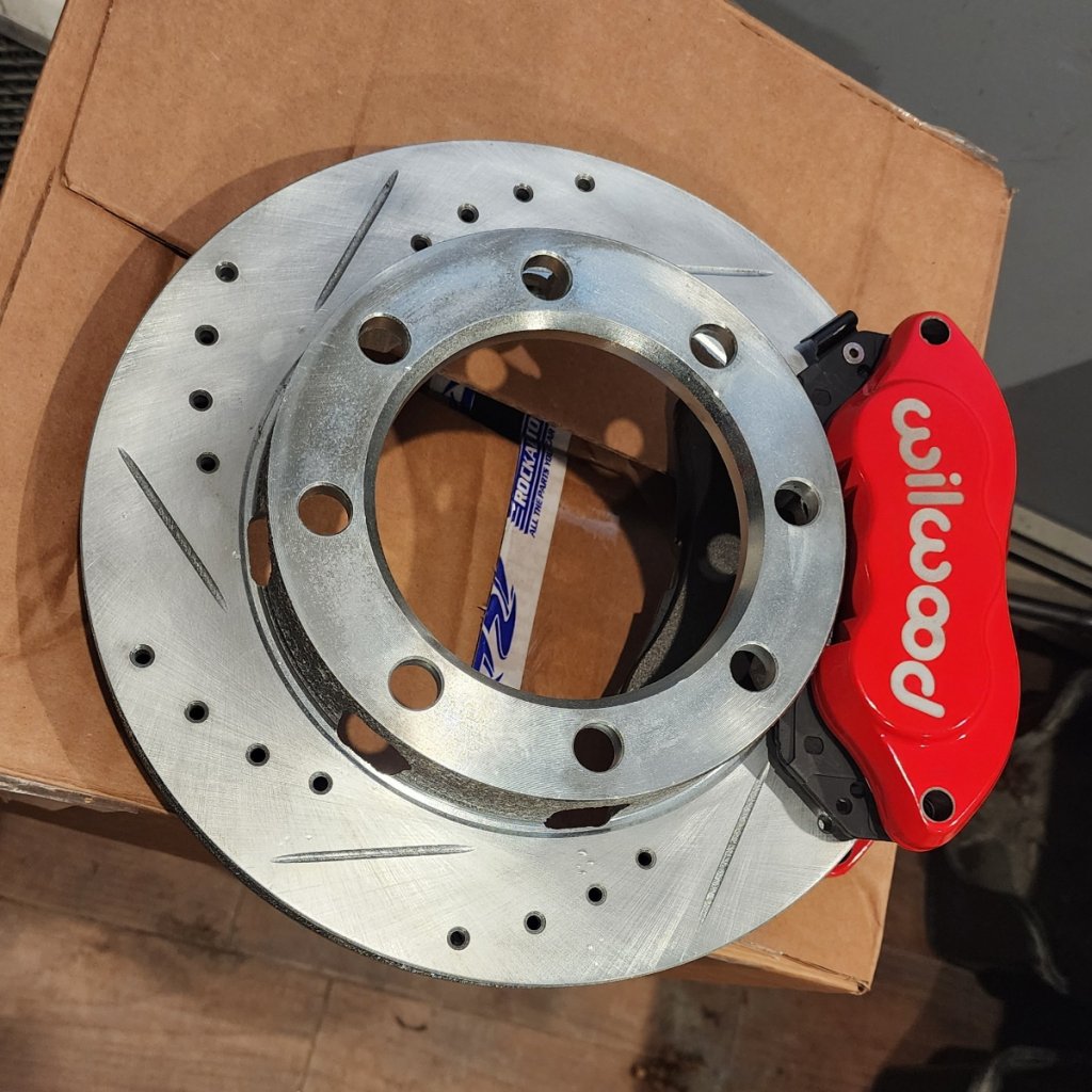

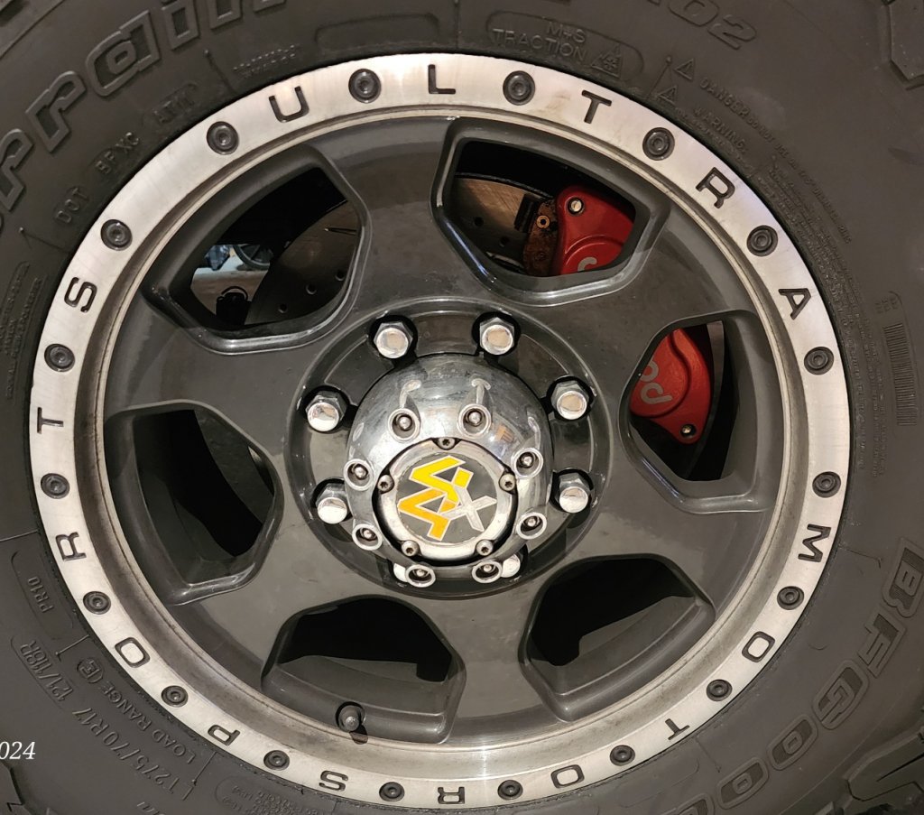

Suburban V2500
I run these wilwood calipers on my V2500
Massive improvement.
