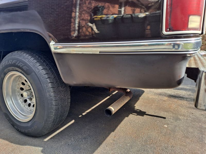

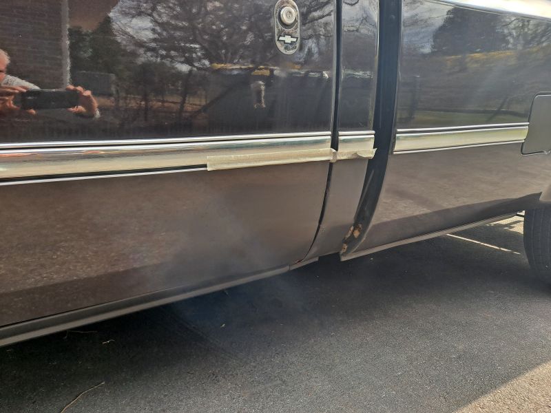

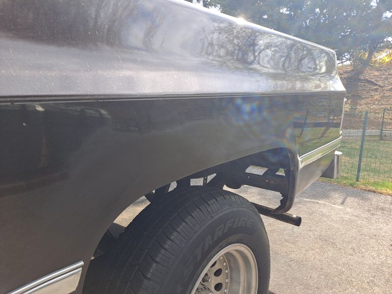

I replaced my rockers, cab corners, above the bed fenders etc. When done wet sanding, I sprayed over the Maaco metalflake with Rust-Oleum 2X Automotive Enamel Custom Spray 5-in-1 Spray Paint, 12 oz, Gloss Clear. Total mess. Had to sand it off actually flaked off with paint scraper. The paint doesn't look bad but it needs shine. Will Spray max USC 2k High Gloss Clearcoat Aerosol work over metalflake? I don't want to repeat another mess. https://www.amazon.com/dp/B0DVWQ1BSS/

It's not a matter of the metal flake it's a matter of shooting a compatible paint over what base. What kind of paint does the truck have on it? And what kind of paint are you trying to shoot over it. Not looking for brands,looking for types.
9,558
17,538
I’m going to say pretty much any generic Amazon cheap spray bomb product isn’t going to be great.
But pretty much any paint or clear will bind pretty well to fully cured and properly prepped painted surface.
If it literally just flaked off in short order it’s likely more of a prep issue.
