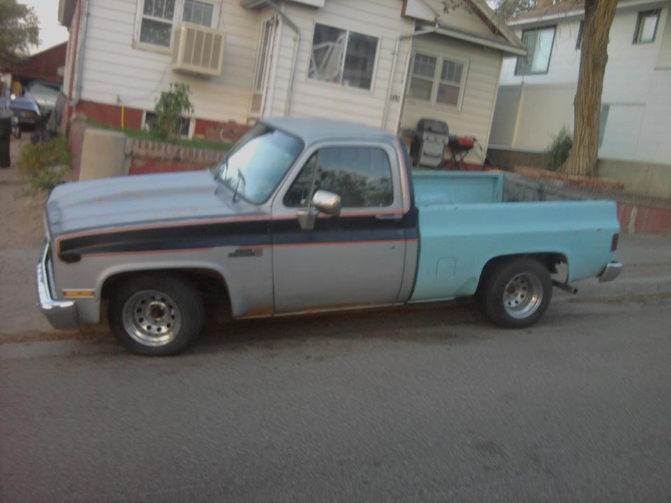

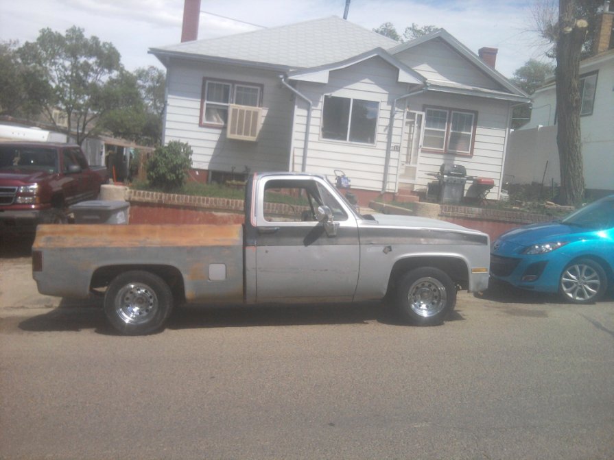

the 85 short bed with the baby blue bed has front and rear drop shackles 4'' rear drop and 2.5 drop spindles on the front.
with the other bed it has a axle flip rear and 1.5 coils cut off front springs
both with 15x8 235-60x15 front and 15x10 295-50x15 rear
the long bed is stock height 15x8 tires ? front 15x10 295-50x15 rear

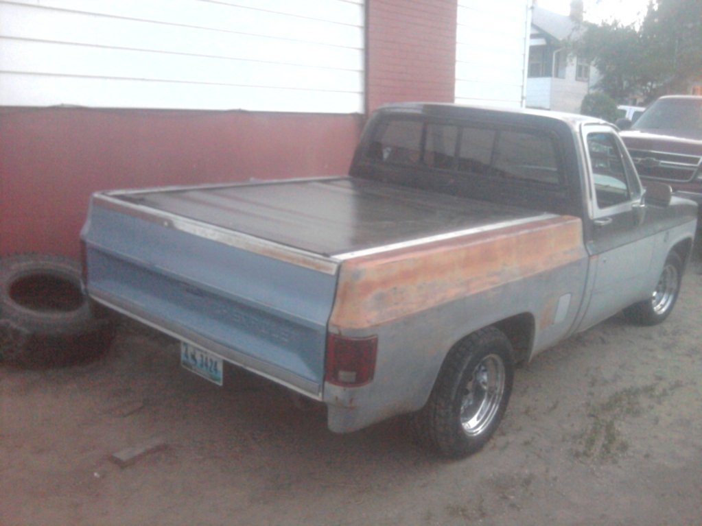

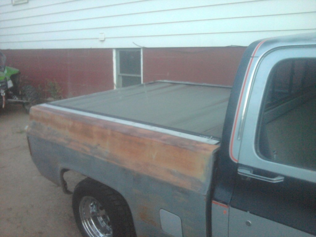

15x10 wheel bolts right on the rear
you will not be able to tuck a 15x10 with a 295-50x15 it is even with the wheel well
this truck has a axle flip around 5'' drop with a 15x10 295-50x15 rear

@kleedus did you ever remember where what truck the bed bed cover was ment for? I like that and was hoping they make one lil longer.
kleedus
Jan 25, 2012
1,726
164
wyo
Ray
1960 threw 91
c10 to k30
350 threw 454
no one of my buddies got it used and made the brackets to put it in a short bed chevy
I have no clue what it was originally for and neither does my buddy that did it

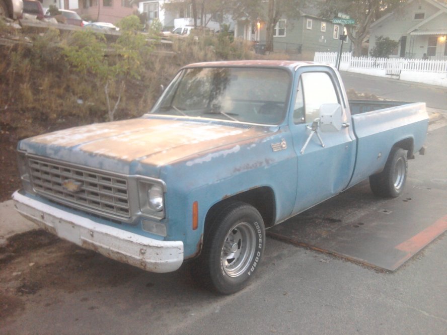

I put 15x10's on this truck. I do not recall backspace. I went to buy wheels and tires for the truck and the guy at the shop had these sitting on the floor. He said someone ordered them and then never came to pick them up and he had them for a while so I snatched them up. I thought the truck looked pretty good with them on.
J Knight
Sep 8, 2011
4,298
145
Baytown TX
82 Chevy
350ci
Those modular wheels are only available in 4in bs IIRC
