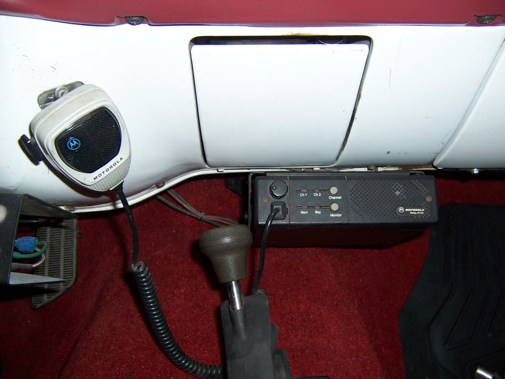

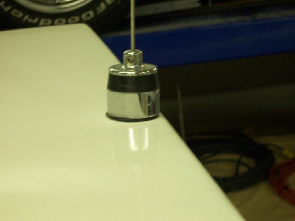

This is how I installed a high band radio. Very similar in size to CB. Used the dome light hole inside for access to install antenna. After a LOT of miles radio did crack the bottom flange of dash frame. A reinforcement bracket is recommended.
