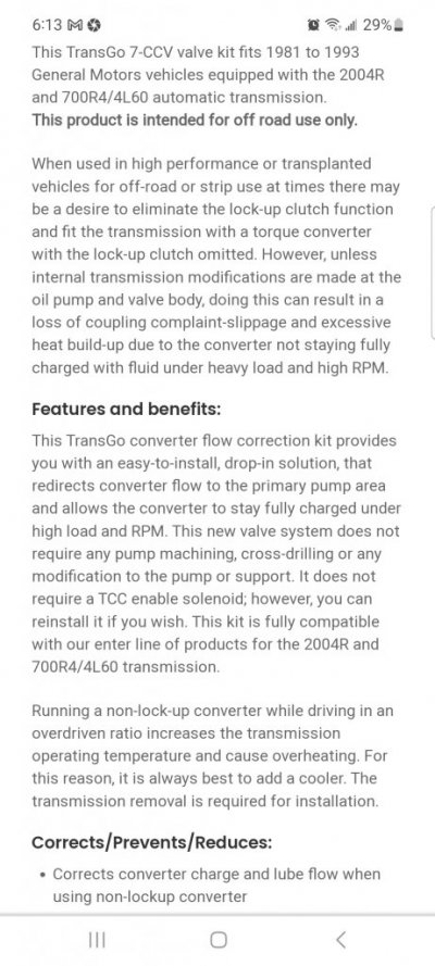

I would make the converter work,it's easy. I am of the opinion that you are asking for a premature transmission failure,they make kits I can't remember who makes it,so that you can run without converter lockup,IIRC it is a check valve that redirects oil in 4th gear. I'd just make my converter work. I found the kit,snapshotted the description, that description says to me don't run without lockup,unless you perform additional modifications.
