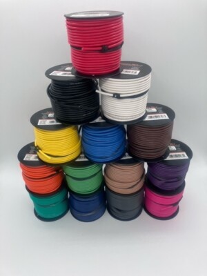

This is the stuff I hit when I wired Bluster up for a trailer in various colors.
Seems decent, but stiff.
Hope it lasts.
