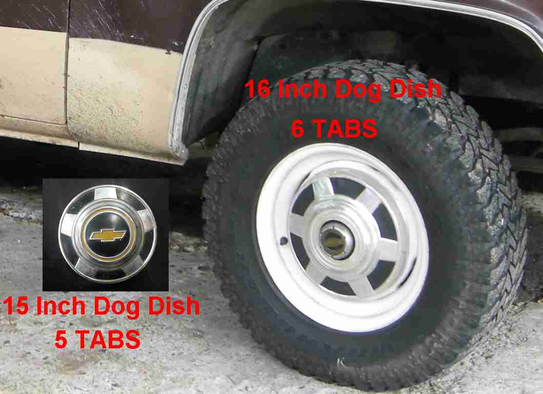

The 16" stock steel wheels use a bigger Dog Dish, about 14" dia, can be identified as having 6 black "tabs".
The 15" wheel uses the smaller 12" Dish, has 5 "tabs".

The larger Dishes can be a bit harder to find, but look around they are out there at a reasonable price. I touch them up w/ a little brush on paint if needed. Will fit your series 82 wheels..

Series 82 will be the larger 14" caps, the 6 tab variety.
From everything I have seen, the 5 lug wheels that had hub caps from the factory were 15" in diameter and used the smaller 12", 5 tab hub caps.
The eight lug wheels came in 16" and 16.5" diameters and used the larger caps.
HTH
edit: If you currently have hubcaps on your truck now, they will fit the Series 82 you want.

I checked ebay and saw that. Well some folks are a bit confused, posting up a picture of a 6 tab dish, saying it 'came off a 3/4 ton' , then calling it a 12" dish.
Simple rule of thumb:
5 tabs = 15" wheel.
6 tabs = 16" or 16 1/2" wheel.

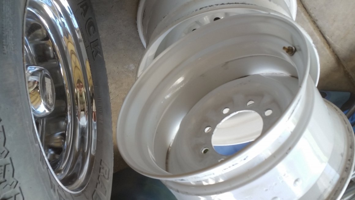

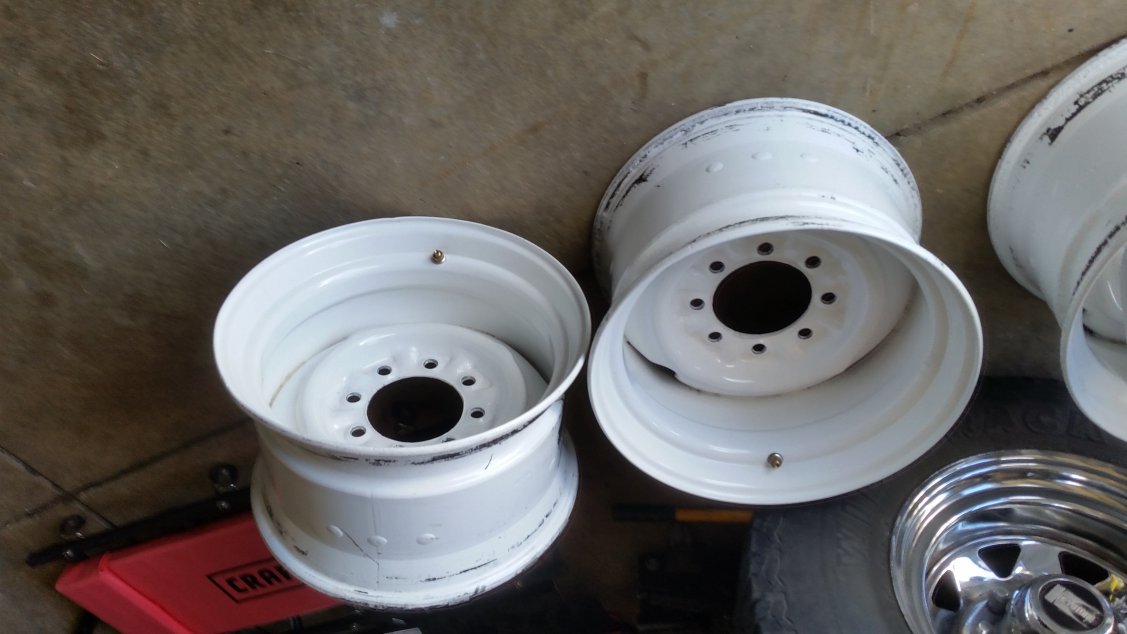

So I found these on Craigslist for $400, freshly powdered,now just need some tires.
